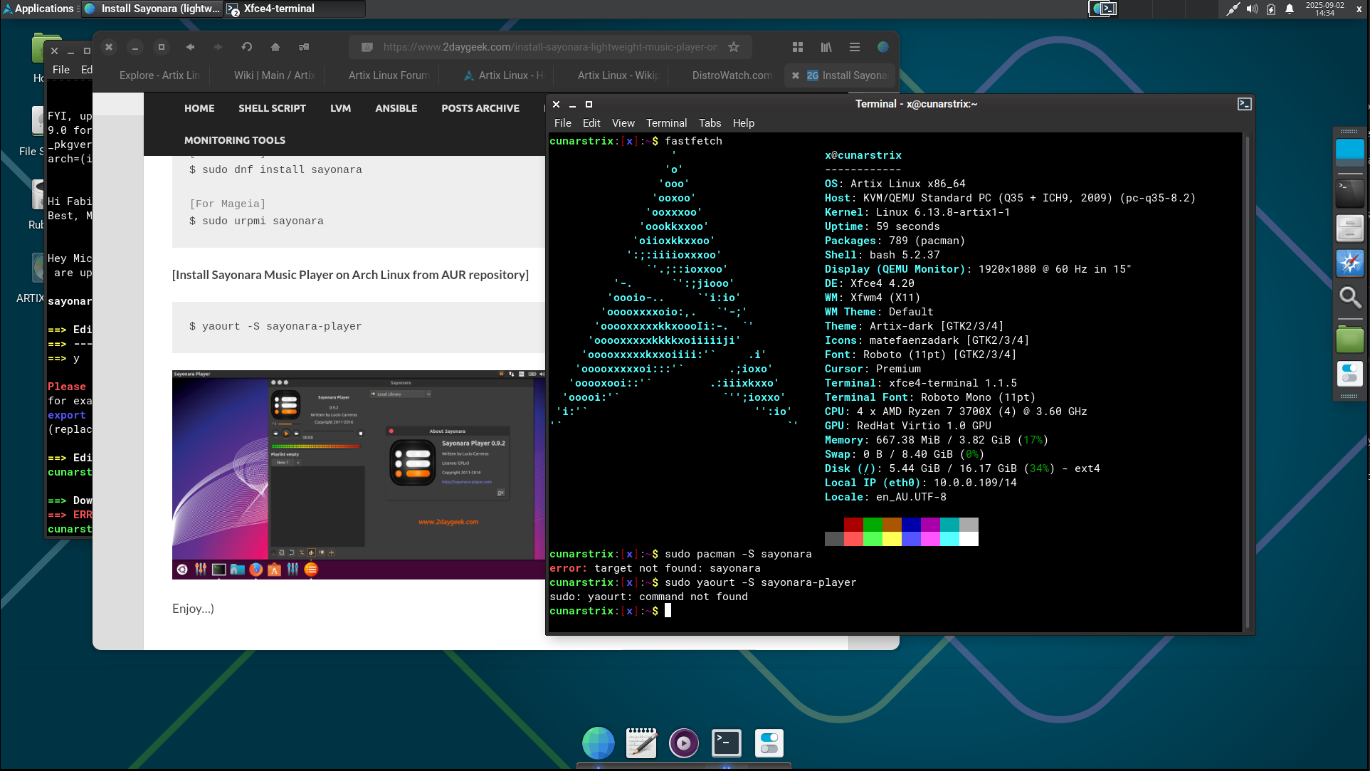

I ran into an issue with Artix - installing sayonara-player… it says to use yaourt - so I had to install yaourt via pacman, then run “yaourt -S sayonara-player” - and it looks like it’s building it from source… and it keeps bombing : with some message about “fakeroot” and I give up…
Well at least you got Artix to run, and like what you saw.
You will test it more heavily than me, because you use much wider range of software.
You may have to dip into the AUI to get some things… use ‘yay’ with pacman… same as in Arch

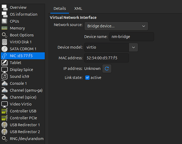

My Artix guest has got an IP address from my WiFi / Ethernet / VDSL router!
I was quite surprised - virt-manager is now defaulting to bridge device on the new VM wizard / doohickey :
Here’s my Artix VM NIC config :
And in the “new VM” doohickey (defaults to bridge device):

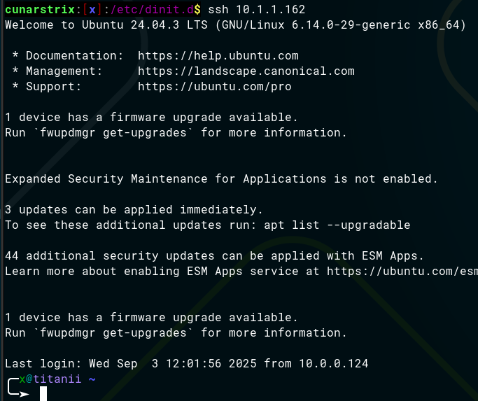

I just tested ssh’ing from my Ubuntu 24.04 ThinkPad - to my Artix VM on my home LAN (hosted on my 24.04 desktop) - and it works! And confirmed - from my Pi4 running Debian / Raspbian 12 - success…
I might try reverting my other VMs (like RHEL 9 instance) to using bridged mode…

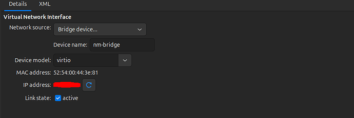

Earlier this morning - my KVM guest (e.g. Artix VM) was unable to SSH to the main IP address of my desktop machine, but it could SSH to the IP address my bridge device is using…
Actually - I’m going to stop redacting my home VLAN IP addressing - pointless really…

So - earlier today - my Artix guest was able to ssh to other hosts on my ethernet (e.g. an RPi4 on ethernet, a Thinkpad on Wifi) - but - not to 10.1.1.162 which is my main NIC on my desktop machine hosting KVM - however I could ssh to the IP address of “nm-bridge” 10.0.0.123 (note my CIDR - /14 - so 10.0.0.123 and 10.1.1.162 are on the same IP network).
But I tried again just now and it worked! And I don’t know why or how!

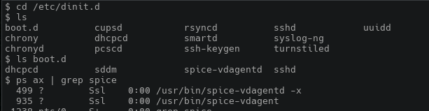

You need to install spice-vdagent in the guest. RHEL probably has it.
And spice-vdagentd. … I think the package should install both.
when you do ps ax | grep spice in the guest you need to see both spice-vdagent and spice-vdagentd running… if not start them by hand.
You dont need anything in the host.( maybe spice and spice-protocol)
I dont have Artix in a VM, but I have Chimera which is also dinit
It has this
so only vdagentd is enabled by dinit.
I think vdagent is started when you open an X terminal?
in Chimera, copy/paste only works with X11, not Wayland.
It is interesting, spice-vdagentd has a different pointer
$ ls -l boot.d
total 0
lrwxrwxrwx  1 root root  9 Dec 23  2024 dhcpcd -> ../dhcpcd
lrwxrwxrwx  1 root root 17 Dec 28  2024 sddm -> /lib/dinit.d/sddm
lrwxrwxrwx  1 root root 27 Jan  1  2025 spice-vdagentd -> /lib/dinit.d/spice-vdagentd
lrwxrwxrwx  1 root root  7 Dec 28  2024 sshd -> ../sshd
It does not point to the config files in /etc/dinit.d.  Maybe because spice-vdagentd is a 'oneshot' rather than a daemon?.... no /lib/dinit.d/spice-vdagentd is a dinit config file with 'type=process' so it is a conventional daemon.
So what is all the stuff in /lib/dinit.d?.... looks like system services?.... Yes udevd is there.
If you look at my pastes - you should see - that spice-vdagent is installed…
I don’t know how to make it run though…
I guess I could just try :
/usr/bin/spice-vdagentd &
But I’d rather get it running via my init system (i.e. dinit)…
The installs of spice-vdagent and qemu-guest-agent didn’t create any entries in /etc/dinit.d/
I tried running spice-vdagentd and nothing was running… So I tried with spice-vdagent (sudo) - and there was a spice-vdagent process running - but still no clipboard sharing in either direction…
Killed it and tried without sudo - and there’s a PID running “spice-vdagent” - but still no clipboard sharing in either direction - here’s it running (connected via SSH) :

Yes it is installed… but I dont see a dinit config file.
You might need to find another package called spice-vdagentd.dinit to get the config files for dinit.
Then
Just use dinit to enable vdagentd
vdagent should look after itself… X11 starts it, or should.
What do you get from ps ax | grep spice in an X window
You should have both vdagentd and vdagent running
If vdagent is not there, start it.
I think it has to be X11, not Wayland.
You may need spice and spice-protocols packages in the host… not sure.
If you look in the outputs I posted above - the output of “ps -ef |grep spice” shows it running… “ps ax” is kinda deprecated isn’t it? I know it’s still the norm on BSD (in fact ps -ef doesn’t work on BSD - I seem to remember you had to use “ps ax |grep process” on SunOs 4.x [which was BSD] but Solaris was a SystemV UNIX - so “ps -ef |grep process”) - but using Solaris and Linux systems last 25 years, I’ve always used “ps -ef”… I have how to kill a pid in muscle memory :

Anyway - I rebooted the Artix VM and it’s working (two way clipboard sharing)… So maybe it needs to run BEFORE X11 is started?
Also - I’m surprised how quickly VMs start in KVM / virt-manager…
Noticeably faster than they do in Oracle VirtualBox… And Artix seems to boot up and load the WM a lot quicker than RHEL9, and probably slightly quicker than Ubuntu 24.04… And Debian 13 (Gnome) about the same time as Ubuntu 24.04…
So - win win : got bridged networking working, and two-way clipboard sharing in Artix with dinit as a KVM guest!
I missed that, sorry.
But only vdagentd is running… vdagent should be there too.
You solved it, vdagdntd needs to be there before x11 starts, or vdagent will not start.

I already did that way way before I got bridged networking sussed out… NFS support is usually my litmus test…
i.e. “mount 10.1.1.10:/mnt/BARGEARSE /mnt/BARGEARSE” worked when I was stuck using NAT mode - i.e. my guest VM was on some hideous 192.168.x.x DHCP lease from kvm/qemu NAT… So my KVM knew how to get to 10.1.1.x VLAN…
Pretty sure it worked as seemlessly on MacVTAP adapter in KVM / virt-manager… But it never worked (nothing worked) when I tried to use bridged mode…
So when magically “bridged” started working - I tried it again - and “mount 10.1.1.10:/mnt/BARGEARSE /mnt/BARGEARSE” just worked…

I had bridged networking running flawlessly in KVM previously (and not sure how exactly - I did eventually get it working!).
Anyway, the other day - I plugged in my RPi Zero 2W “gadget” and tried to config the USB ethernet “gadget”… without realising I was tampering with my working bond on a USB gigabit adaptor - now it’s ALL BROKEN!
Doh!
Now my bridge device has some random MAC address… I think previously it has the MAC address of the USB Gigabit NIC… and it was getting an IP address from my router…
Maybe I have to reboot? Not doing that just yet… still few hours more work left in Friday…
I guess I’ll have to go back to macvtap or NAT - but I’ve now got 13 KVM guests… PITA…
