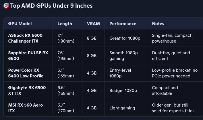

I assume anything marked “ITX” would fit your need.
Myself, I have the space for the length of the RX 6700 or 6800. But I asked CoPilot about the ones for my case and motherboard that are under 9" and none of them would fit your space. Here is what was suggested for under that:
