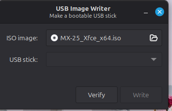

Quite honestly, I can not remember the last time I used the dd command. I use the Nemo file manager that comes with Mint to perform my file copies. In the drop down menu for an ISO file is an option called “Make bootable USB stick”.
Using this option making an USB boot drive from an ISO file is almost is fool proof.
Using that “Make bootable usb stick” button is probably a good thing to recommend for beginners.
I assume it asks for
  • name of iso file
  • device name of usb stick
So you can still make the same error as with dd and write on the wrong device.
Since the “Make boot-able USB stick” option is in the ISO file’s context menu, the only risk would be to choose the wrong destination drive, but I’d have to use the option to know what safeguards against that possibility are in place …

It would be very hard to mistake with Nemo. The drop down menu for making a bootable USB only comes up if you right click on an ISO file. Then the next screen comes up.
Looks like the only error you could make would be if you had 2 USB drives attached and selected the wrong one.

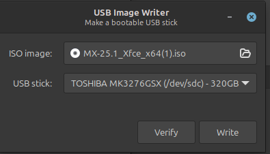

What about USB driven external drives?
Can it tell those from flash drives?

No, it can not.
I attached a USB drive and a USB attached HDD and the boot maker will let me select either one for output. The window does show the device selected.
