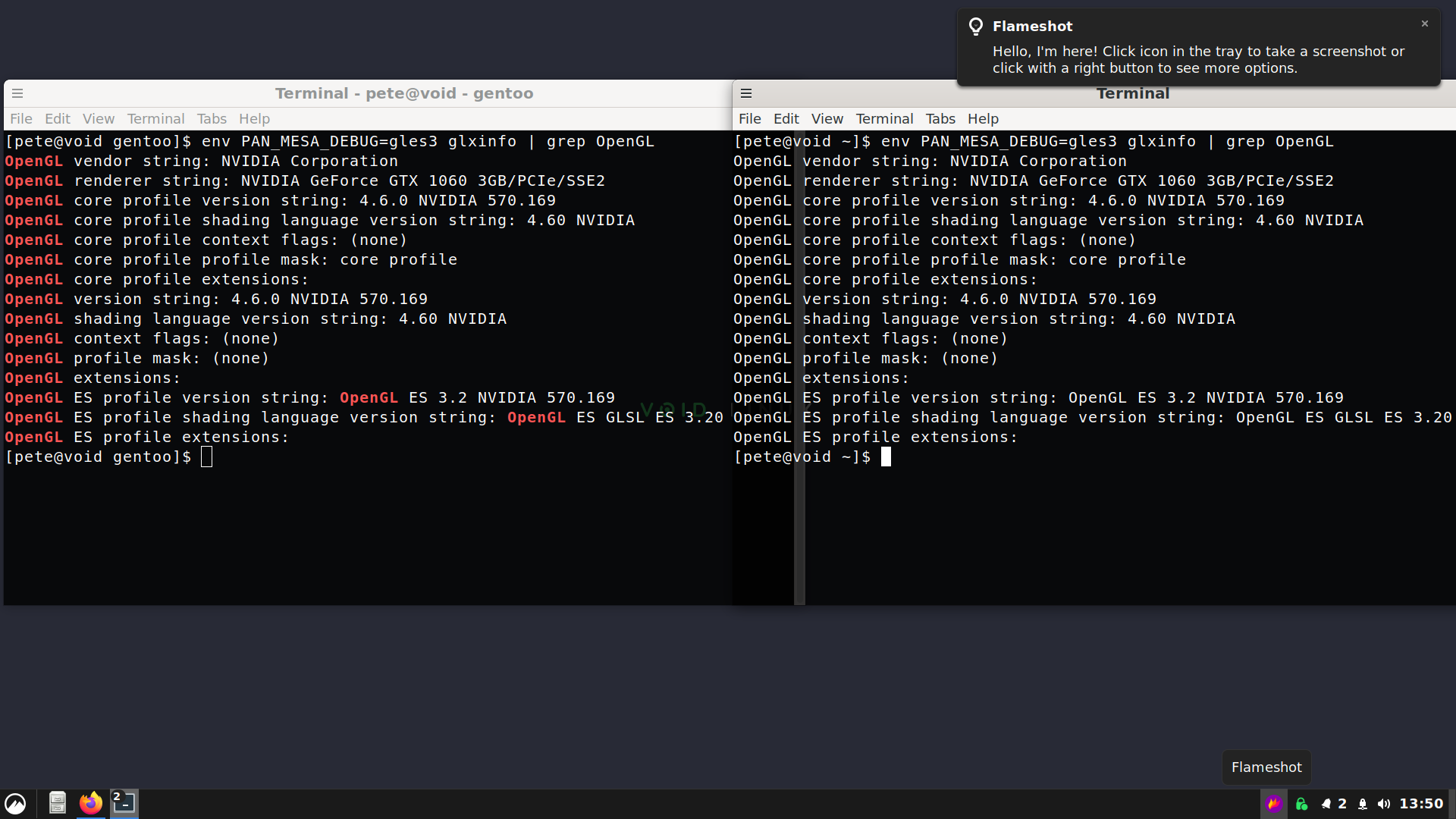

I don’t know how to proceed from here. Heres env PAN_MESA_DEBUG=gles3 glxinfo | grep OpenGL : left terminal “Gentoo” and right Void

According to this, it’s using Wayland. When I did my experiments of using GUI programs built with a different compiler and dependencies, I used X. X is client server, so you can run programs and view them in X Windows even if they’re not using the same libraries or even when they’re not on the same operating system. I don’t believe Wayland has that capability (at least without using XWayland). I think you’d need to run the version of Wayland that you build with the gentoo environment. LFS does a chroot and runs the applications from the directory where its builds are. If you used the operating system’s native packages including the Wayland and Mesa libraries with your build of alacritty that should work too (assuming the compilers used to build the native system and the new system are compatible). It matters how you mix and match packages from the two systems.
Sorry for my late reply! There’s both use flags, X and wayland. Void is using X but when I’m inside the Gentoo prefix I get no output from
echo $XDG_SESSION_TYPE
Maybe that’s the issue? How to add session type to the environment? I tried this:
Environment"XDG_SESSION_TYPE=X" and same with Wayland but no change
Did you export DISPLAY before running the application and is it using the same DISPLAY setting as your X server?
