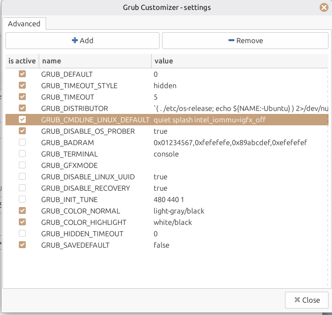

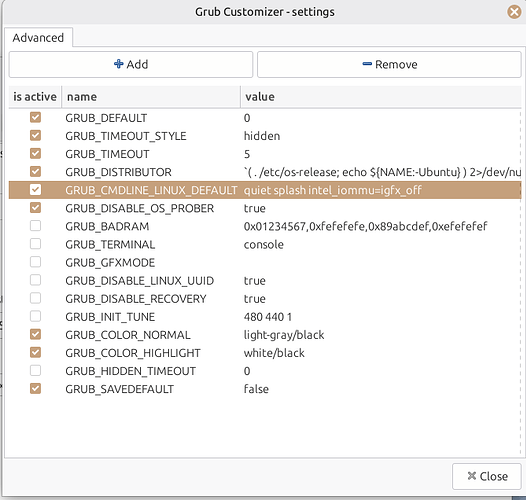

I’ve just replaced Windows 11 with Linux Mint 22.2 and I had the same screen blanking issues.
My PC has an Intel Core i9-9900T CPU.
Using the Grub Customizer app I modified the boot settings as follows:
The problem is now resolved.
Many thanks to the Foss community.
Steve Dec 2025
You dont need to use Grub Customiser to make that change to boot parameters.
You can edit the /etc/default/grub
then do update-grub
You can also test such a change by doing into edit mode in the grub menu.
Move the highlight to the line you want to boot, the press ‘e’ and you will get an ddit screen. Go to the line that begins linux ... and add the boot parameter. Press F10 to boot. The change is temporary… ie just for testing.
