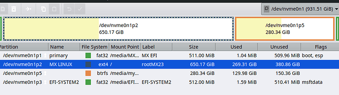

1.1 MB in use. Now here’s gparted display of the internal nvme drive:
Does that look good? Can I use Thunar to view the MX EFI partition and see what is on it?
I do have other images from yesterday as I made one of the whole internal drive as it was then as well as Garuda and its EFI by itself.
Looks OK as far as partitions go

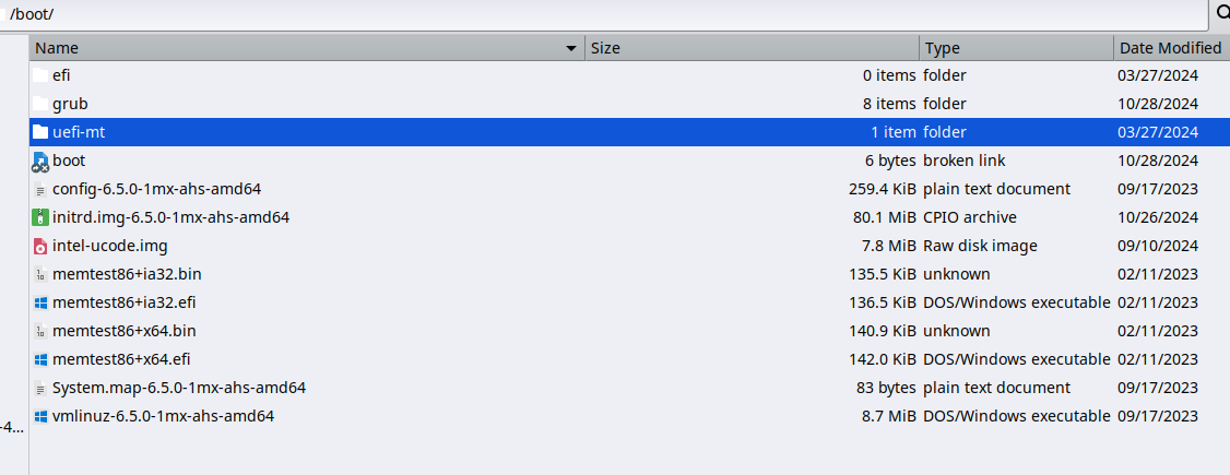

Here’s the /boot folder on current MX session from internal drive:
There is nothing in the efi folder.

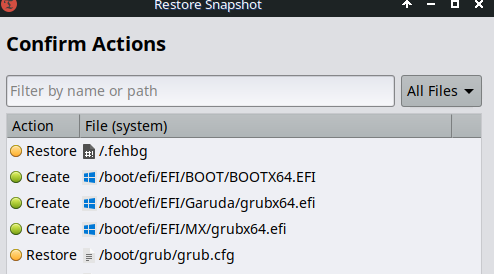

I thought of another option. I looked at my Timeshift snapshots and found one from Oct 27. Upon hitting restore, I checked the Advanced section and it actually resets the part 1 EFI as well as reinstalls/rebuilds grub. So I am going to try that first as it will supposedly set everything back to that date. I already made the CZ image of the entire drive from yesterday, so worst case we are back to square one.
This is what it found to have to re-create:
Will update once I see what the Timeshift restore does.
Okay, Timeshift worked. I still have 2 entries for the internal NVMe drive in BIOS, but I chose the first one, set the second to boot next, and my original MX grub menu appeared (the one without Garuda on it). I booted from there to MX.
