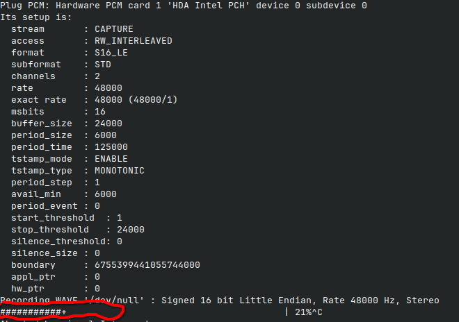

This is my current opinion on the matter:
ALSA - Advanced Linux Sound Architecture
From what I’ve read, ALSA is part of the kernel.
The arecord -l command can list all available recording devices, cards and device numbers.
In my case, my webcam card is 1 and the device is 0.
Check in alsamixer that the microphone is not muted and set the volume to maximum, then run the command arecord -vv --device=plughw:1,0 --format=dat /dev/null there should be audio in the VU meters, for example:
From what I’ve been able to ascertain, if there is no audio, it’s either hardware or kernel related.
