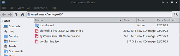

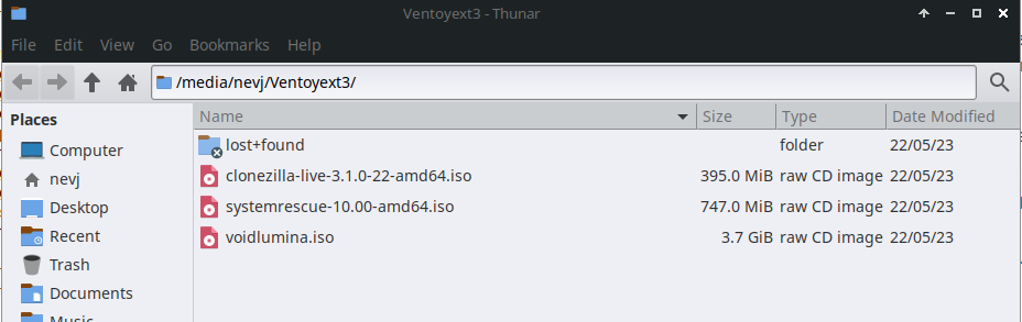

It made an exfat filesystem.
So how did I get ext3?
I presume that after the install finished, I reformatted /dev/sdg1 to ext3… in my usual stubborn manner.
I always put an ext filesystem on Linux usb drives, so I must have overridden what Ventoy install did.
My usb drive boots OK… I have Clonezilla , Void, and SystemRescue on it.

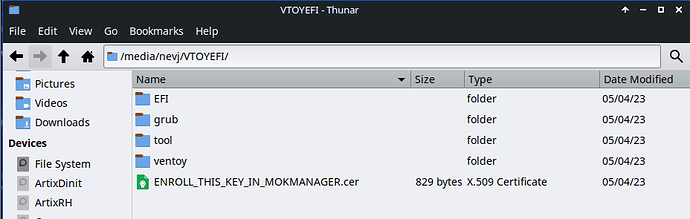

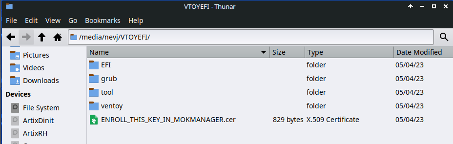

I should not matter what filesystem the first partition has. All it contains is copies of the .iso files
All the ventoy code and boot procedures are in the other fat partition
Those folders contain heaps of files, all to do with various types of boot, including EFI system partition stuff.

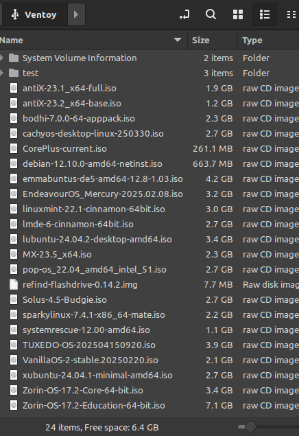

I have rarely come across a device that wouldn’t boot from Ventoy, it can happen though. I have some bootable Mint Linux, WinPE and various system rescues just in case. Some of the distros have issues with some of the hardware, but Ventoy itself is never the problem. This is what I’ve been playing with lately:
