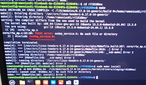

Anyone has a good source for a functioning driver for rtl8188eus chip for my up-to-date Linux Mint?
Because AI only delivered ones that are not compatible with my kernel, and the one I found manually didn’t either …gave an error while adding. It feels I am going in circles…
Error! Bad return status for
module build on kernel:
6.17.0-14-generic

Tried three from github, guided by AI, the first gave an error which apparently meant my linux was too modern for it. The second didn’t want to download at all, kept asking for a password. And when I manually found one specifically for my rtl8188 and mentioning it supports the newest linux mint 21/22 kernel 6.1x it gave an error while installing, which according to ai said that this Linux was too new for the driver, so it also was out of date…
according to the text it should work, but it doesn’t.

I am not sure of much regarding this, only that it won’t install in any of three ways suggested by AI on thinking level and after asking if it is sure about the way to do it… and that my WiFi was so slow it let everything online time-out, I am sure of that too. After some tests, iwconfig. ping and traceroute I saw how slow it all is and since everything else on the router is working perfectly normal I was pretty sure it was this device, and highly probable the newly acquired wifidongle…
But if it really all doesn’t work on this build, only half knowledgeable about it tbh. I have some of the screenshots, well pictures, of the terminal errors and such… if you’re interested:
for the last I copied this, looked sensible
sudo add-apt-repository ppa:kelebek333/kablosuz
sudo apt update
sudo apt install rtl8188eus-dkms
and got this
(as new user I could only upload one media…)
What happened after this command? Did it install ok?

" The osdep_service.h (or similar, such as osdep_service_linux.h) file is typically found in Realtek Wi-Fi driver source code, such as those for rtl8812au or rtl8821au. It is not usually provided by a standard system package but rather through kernel module source packages, such as:
  • rtl8812au-dkms (or rtl88xxau-dkms)
If you are compiling a driver and missing this file, you likely need to install the DKMS package for your specific hardware or the linux-headers package for your current kernel (sudo apt install linux-headers-$(uname -r))."
That came from a google AI summary

I shared exactly that picture with the ai and it told me it didn’t install correctly and advised me to remove what had been done to avoid conflicts, which made sense to me. And I don’t want things gobbled up, so before continuing I made it undone…

When I mess around like this anyway… I could try and get the actual built-in wifi working too
Does this site here make sense, anyone can assess if this could work:
I think I decided to simply wait, thanks for all your input, it may not have solved it literally speaking but it has helped me to decide what to do, I appreciate all the input here, thanks!
This is what AI just told me after I fed it the site I shared last:

Not really.
There is nothing magic about the CLI interface.. It js just that it is often the only way to do system work. it does have the advantage that you can script what you have done.
I’ve been trying to follow this, but I might of missed it- Did anyone mention power saver? (wifi power saving and usb auto suspend)
That was mentioned by the ai, i checked and powersafer was off actually, so not the culprit
