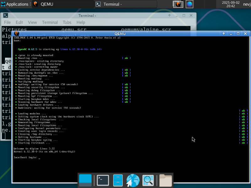

I get a large qemu window, but it can be resized to look like this
The text is a tad small, but it is workable.
It is showing the alpine boot.
That will do me. … I can get on with configuring the Alpine VM.

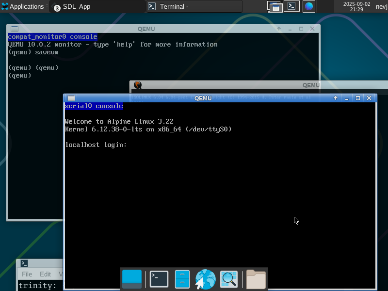

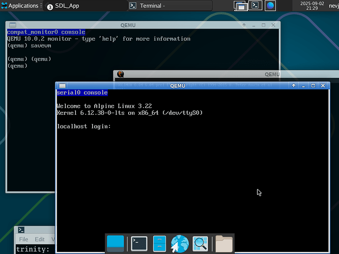

I have made another discovery
ctrl alt 3 gives me a serial console in another window… with decent sized text
So I can work there. I dont really need graphics.
also
ctrl alt 2 gives me a ‘monitor’ console in yet another window. I has a (qemu) prompt where I can type commands to qemu… like telling it to save the VM… useful, I wondered how one would save

Here is what my screen looks like now
I can work in the serial console, and the monitor console lets me issue commands ( a bit like using the menu in Vbox)
I still have the graphic window if needed
