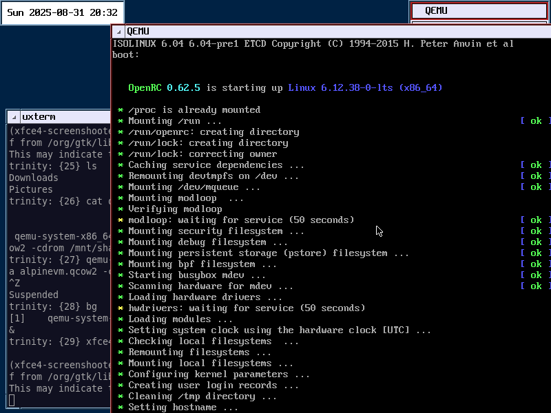

It boots (slowly?) brings up a small window, then about half way thru the boot process the qemu window becomes large…so large I can not access the bottom line… because my NetBSD screen is only 800 x 600. … but it does boot.
It looks like this
That is the CTWM window manager at 800 x 600 in NetBSD. You can see the qemu window hangs off the edges and I cant resize it… Alpine sets the size while booting. If my amdgpu worked it would be OK.
