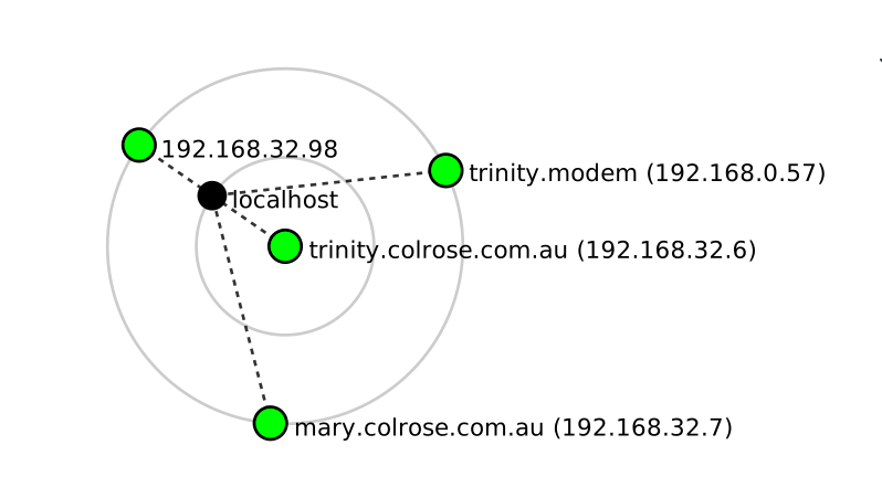

Three things are strange in that topology diagram
  • it calls 192.168.32.6 trinity… trinity is the host not the VM?
  • it can see Mary ( computer on local net) but it does not see a VM on the same neyt? It only sees the interface to it in the host.
  • it says there is access to 192.168.0.57 via localhost ( the host) but pings from 192.168.32.6 dont get there?

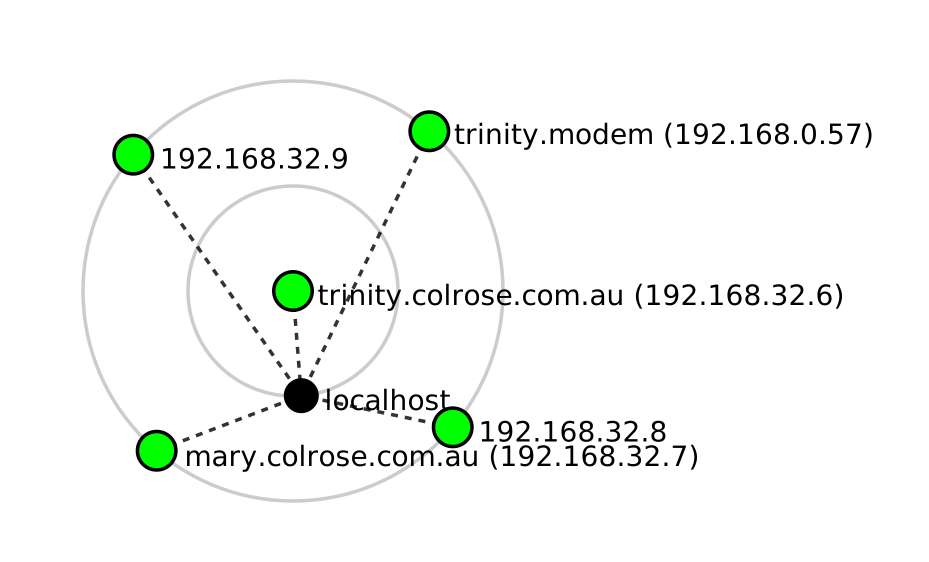

The network topography is now like this
ie it sees the two VM’s as separate nodes, as well as the bridge.
Before it could not distinguish the bridge from the one VM.
So that confirms it, each VM and the bridge should have a separate IP’s
I used zenmap to draw those togographies. It is not perfect… it does not recognize the bridge… it treats it as a computer which it is … it is an interface on the VM host but not the same as localhost. It does recognise the modem.
