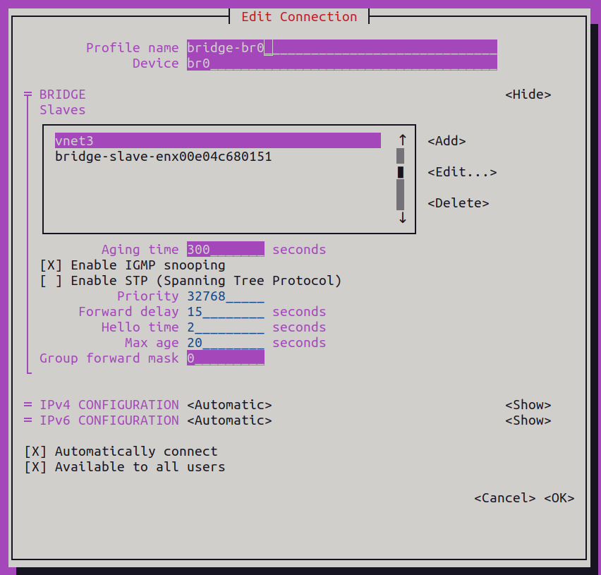

From my shell history - this is what fixed it (needed to reboot after these commands) :
sudo nmcli con add type bridge ifname br0 stp no bridge.mac-address 00:e0:4c:68:01:51
sudo nmcli con add type bridge-slave ifname enx00e04c680151 master br0
sudo nmcli con mod bridge-br0 ipv4.method auto
sudo nmcli con up bridge-br0
Note - reboot may not be necessary - probably down then up the link would do it too? Was easier to reboot in my case… When I want to take a look at that connection in a more human friendly format - I run “nmtui”…
That “vnet3” slave device is “dynamic” i.e. virt-manager only instantiates that when a VM is using it (I’m running my new Mageia install)… I’m always very careful not to change ANYTHING!
Note : someone else’s device will have a different NIC device name and MAC address…

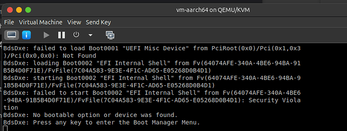

I recently tried to emulate a Pi3 (arm7l [although Pi3 is aarch64]) to run Raspbian - and hit a few snags and gave up… (Note : on MacOS M1 - I use “UTM” which does heap of heavy lifting for doing QEMU) I’ve also tried emulating sparc on x86_64 qemu/kvm and gave up… I have an ancient “to do” I intened to do : emulate PPC (PowerPC) in qemu and install AIX (IBM’s UNIX) - but never gotten around to it…
Same here… it’s essentially just a NIC… and if you only have WiFi and run VMs - they’ll be using the WiFi as if it was an ethernet NIC.
Actually - was aarch64 I tried to emulate :
I reckon I could probably easily enough use qemu to convert a Raspbian image (img file) to a qcow2 file… I’ll get around to it one day :smiley:
