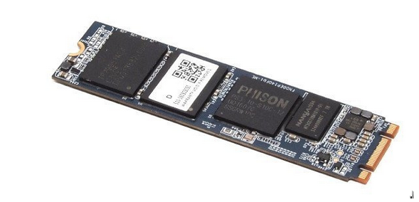

  • I turned the laptop over to take a look at its rear side and discovered a separate compartment saying ā€œSSDā€. I opened the flap on the rear side of the appliance and found the following SSD built-in:
  • ItĀ“s a ā€œPHISON PS 3111 - S11 - 13 M.2ā€
  • looks like this:
  • itĀ“s fastened with one small crosshead screw only. So why should it not be removable :red_question_mark:
