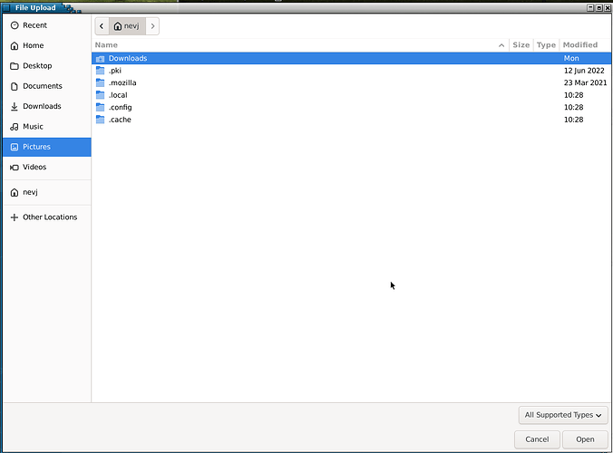

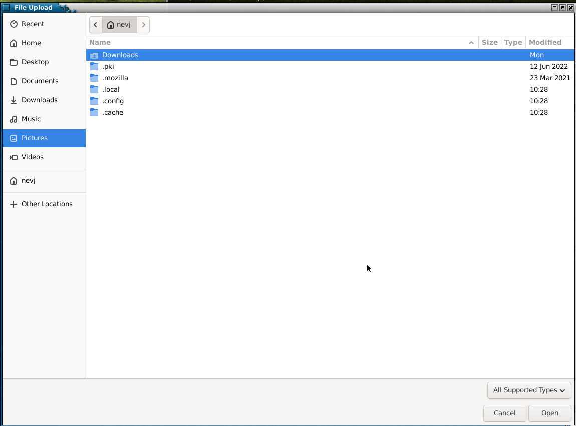

When I try to upload an image to the forum in Void linux ( glibc version) it displays a selection window that only shows a small number of the files in my home directory.
You can see it detects the directory Downloads and a few dot files, but nothing else.
I had to copy the above image to the Downloads directory in order to be able to upload it.
The problem does not exist in MX or in Void with musl, only in Void with glibc., so it is not a discourse problem.
I tried all the options on the File Upload window… no difference.
I am beginning to wonder if there is something wrong with my home directory … discourse can see all other filesystems. Maybe a bad filename or too many files?
The screenshot program has no trouble finding ~/Pictures directory… but discourse can not find it?
Any suggestions welcome.

Perhaps it’s an issue with your software stack? Many browsers use the DE’s default file picker.
Tried that… it can not see them
If I try to enter the Picture directory it does nothing… it can not see the Picture directory..
It refuses to look past Downloads in alphabetical order.

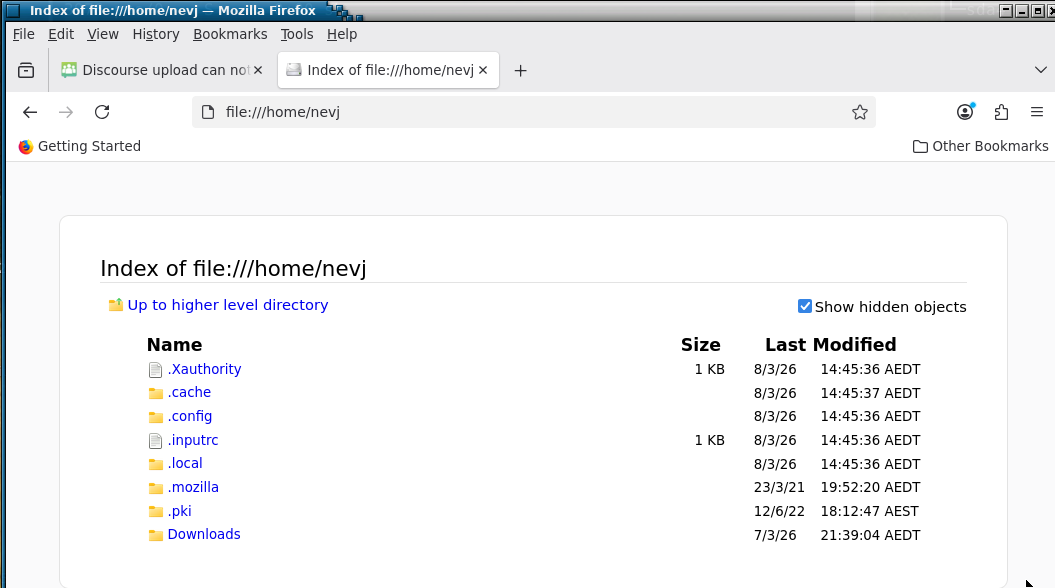

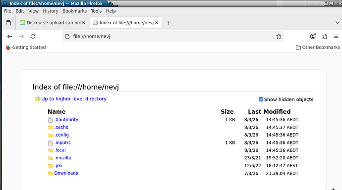

Thunar can happily see all the files in /home/nevj … it is only the discourse upload that can not see them ?
Another attempt:
The problem is in firefox… it can not see all my files.
So discourse must use firefox to do its file search.
I have to fix firefox?
Anyone know about finding local files in firefox?
It seems that my firefox in Void is running inside a sandbox

It says that firefox is sandboxed by firejail .
I never did that?
All I ever did with firejail is use @Rosika 's script to do firejail --private firefox with a few parameters, when I need a secure browser. But that is temporary.?
How is it that my firefox is permanently firejailed?

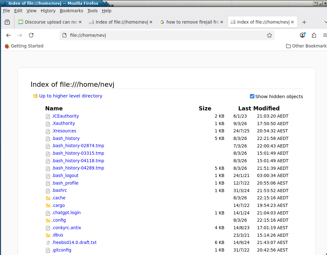

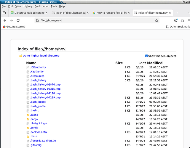

It seems to have been sandboxing a whole heap of things?
Restart firefox, and now it can see my home directory
Now it can see my home directory, and I could upload the saved image.
I could have just manually removed /usr/local/bin/firefox …and left the others. They are links.

@Rosika … you dont need to worry, I found how to clear it.
It should be obvious now… the reason firefox could not see my home directory files was that it was operating in a sandbox which had its own private homedirectoy which only contained necessary files like .Xauthority, …
the reason discourse could not see my home directory was that firefox could not see it.
