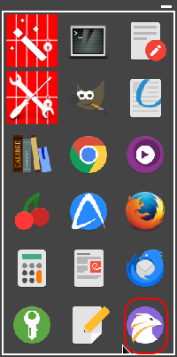

It´s already included as a quick-launch symbol in my firetools GUI.:

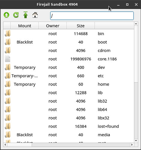

That´s great. With it you can dig even deeper.
E.g. with firetool´s built-in File Manager:
