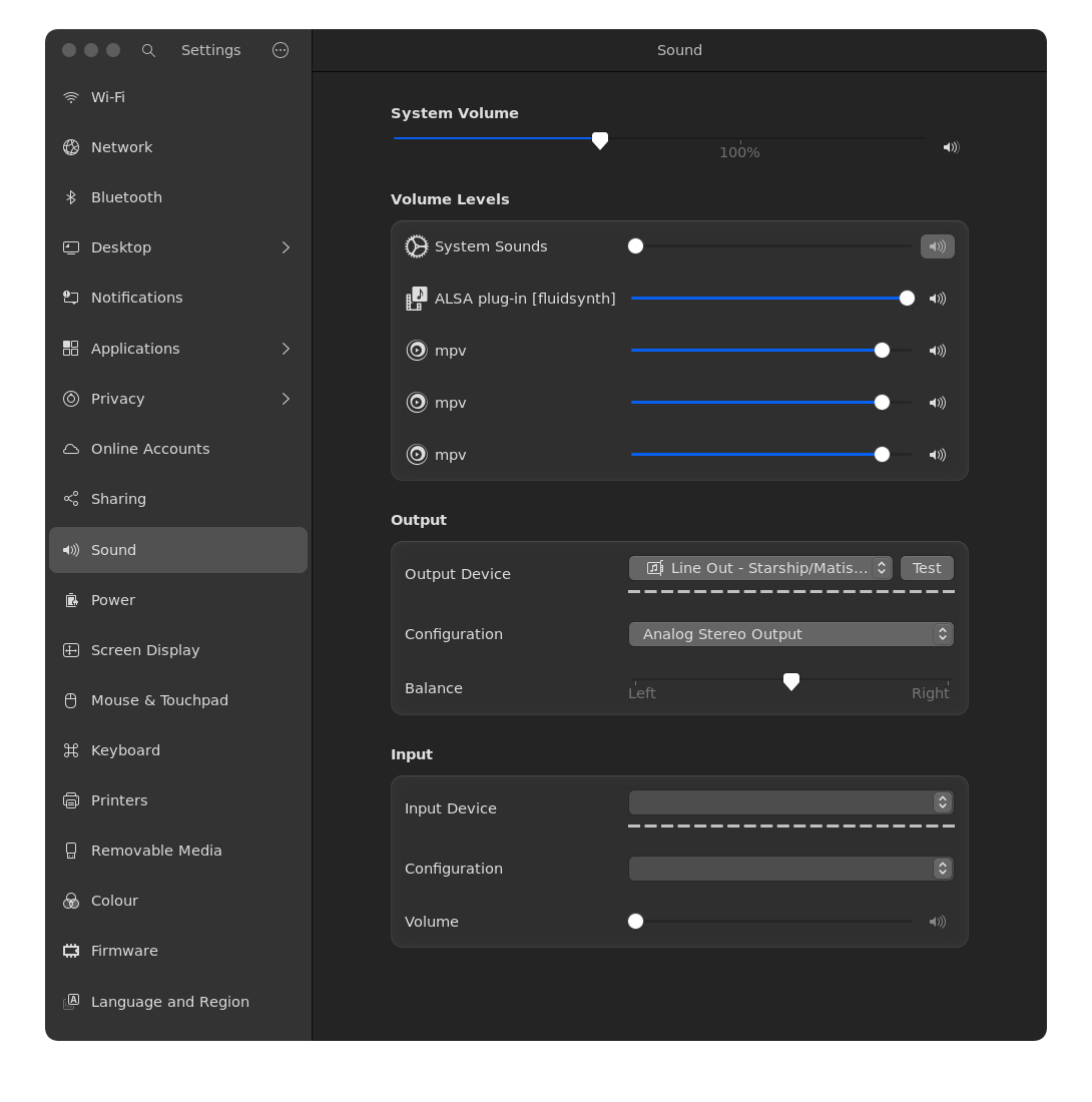

Hmm, I was wondering…
Anything new in it? :question:
As far as screenshots are concerned, I think ChatGPT promised a bit too much. It can only provide text output to me.

What is that?
I did say I was a sound novice.
I think you could write a separate article… ie do it offline in markdown like we did with some of those joint posts.
The chatGPT text helps, but it is not everything.
I can help if you want, but it is your thing… there is an opportunity to make a really useful contribution here.

I dont seem to get any sound out of my machine without fiddling with pavucontrol?

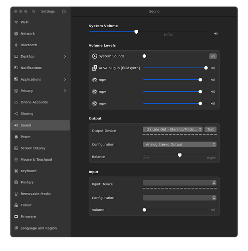

These days I default to whatever the default “mixer” audio control in Gnome is … available in the top panel…
Sometimes I have to run the Gnome Settings applet if I want finer control… again - the default in my version of Gnome (42 on Pop!_OS 22.04)…
I hardly EVER need to fire that up though - only occasionally if/when I decide to run audio out over DisplayPort to my main monitor, or finer control / settings if I occasionally switch to BlueTooth audio - but - 99% of the time I just listen to Audio via the 3.5 mm output jack on the back of my motherboard (“Starship / Matisse”).
Also - I mostly use a Lenovo ThinkPad keyboard (on my desktop machine too - wireless Lenovo ThinkPad II keyboard - with trackpoint) and press Fn+F1, F2, F3 to mute, or decrease / increase volume - it just “works”…
Modern Linux is really, mostly, remarkably mature and plug and play…
Oh, I see… there is a sound thing under settings
I guess it is a better place to make adjustments than pavucontrol.
Thank you.
My ignorance on sound matters is being repaired.
