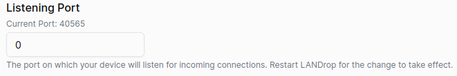

I asked Copilot and looked at LANDrop FAQ, then tried it on my laptop. It looks like it uses UDP 52637. At least for discovery. Not sure if the same is used for file transfer or not.
@pdecker
Is this what you are meaning?
It did say you could change the port to something custom. Did you change it to 40565?
No, that number is different everytime I fire up landrop.
The zero you see in the box can be altered - or+ but think leave that be.
