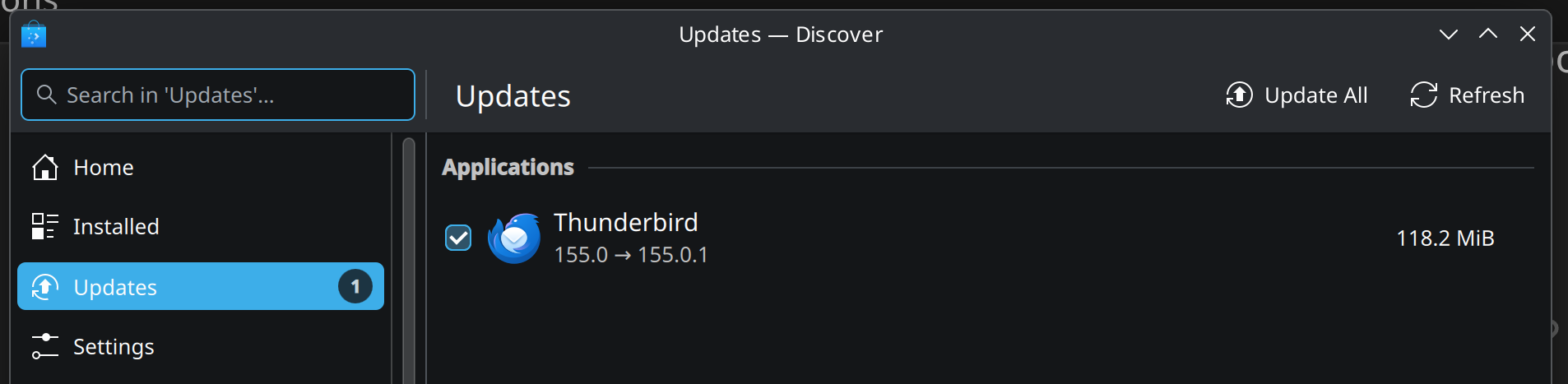

In my experience, Flatpak ties to Discover in my KDE Plasma and does update the apps I care about regularly. On rolling releases such as OpenSUSE/Fedora, I’ll see the multi-gigabyte monthly lib and app updates included in Discover, I suppose it’s possible to filter out OS updates, but this gives me a comfortable middle ground between constant downloads (OK, not as bad as Windows 11) and critical apps such as Thunderbird/Brave/Obsidian, that I want to be latest releases at all times. I can get critical updates for NixOS through their “rolling” channel, but the main idea for me is to install a scant few apps, rather than OTB-type things like LibreOffice, Akonadi and other apps that update regularly (in 15-20 languages I don’t use). Got to be some reason the latest Ubuntu ISO files are 7.x GB, almost as large as MS installers!
This just popped up as I was typing, it appears only Flatpak and supporting libraries are being updated, and the cadence and byte totals are more reasonable than rolling releases (I have seen upwards of 3 GB downloaded for monthly updates on OpenSUSE):
