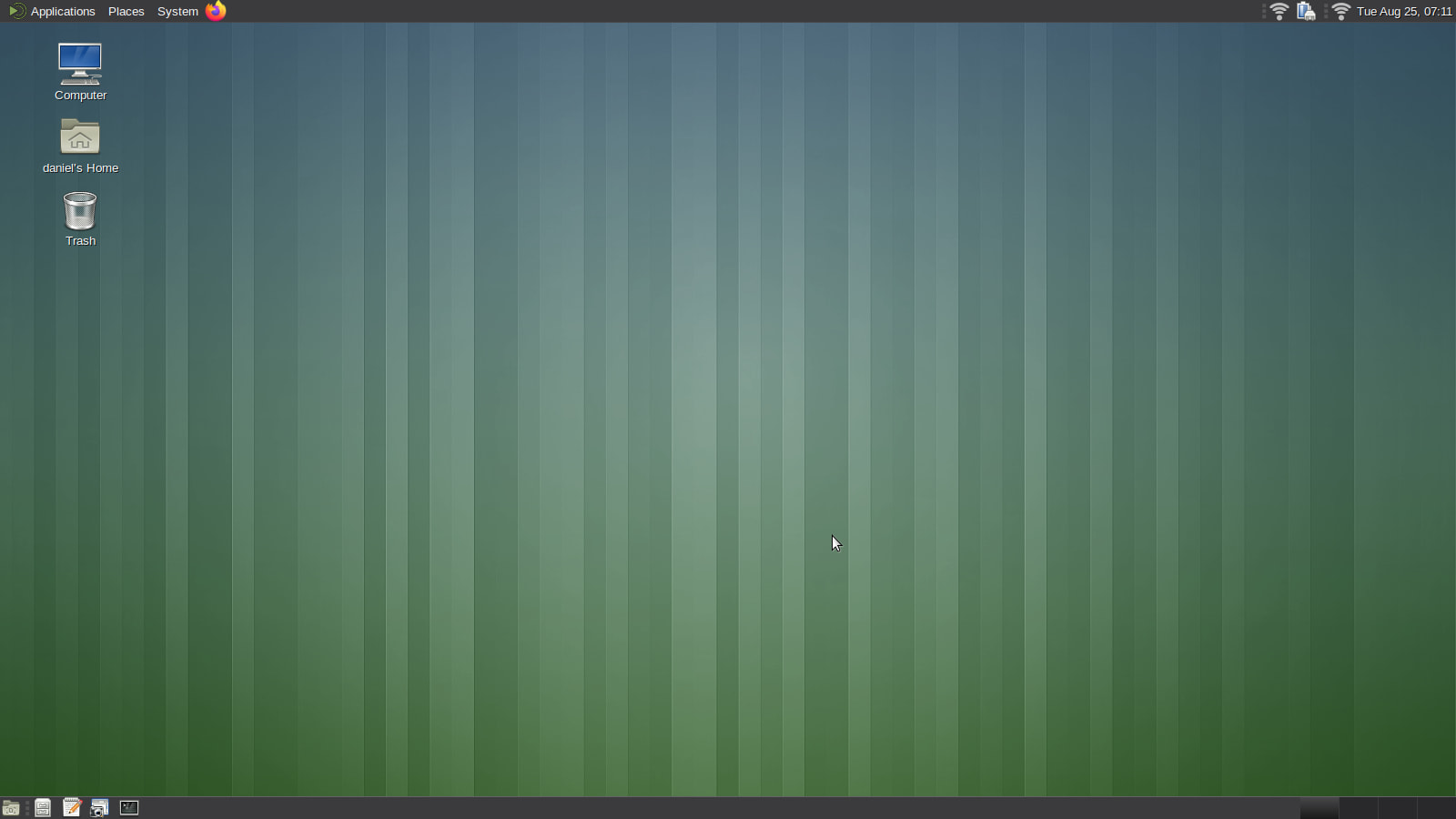

OK, drug my old Dell XPS out of retirement and compiled Gentoo!! Since this laptop has both Intel and Nvidia graphics, I had to set VIDEO_CARDS=“intel i965” so it does not pull in Nvida!! Am also using wpa_gui for wifi login, NetworkManager just had to many issues for this Mate de, while wpa_qui is not auto wifi sign-in, the end results are the same!! Yes Debian would probably worked, but I would then have to blacklist everything “Nvidia”. so I chose Gentoo and built Linux, the way I wanted!! I still have not enabled binary packages, but I did build “gentoo-kernel-bin” and “firefox-bin”!!

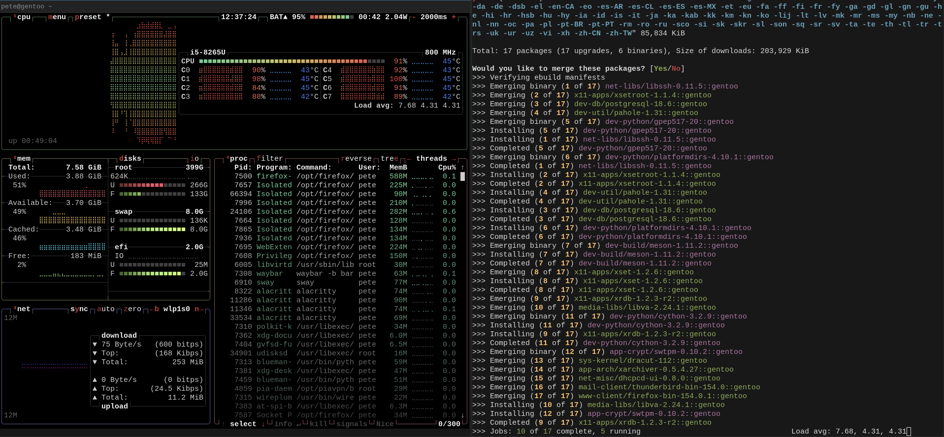

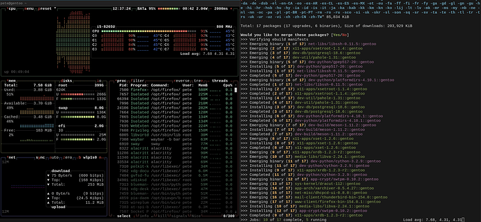

My machine has this:
System uname: Linux-6.18.43-gentoo-dist-bin-x86_64-Intel-R-_Core-TM-i5-8265U_CPU@_1.60GHz-with-glibc2.43
KiB Mem: 7958456 total, 883528 free
KiB Swap: 8388604 total, 8388604 free
COMMON_FLAGS=“-O2 -pipe -march=x86-64-v3 -flto -Werror=odr -Werror=lto-type-mismatch -Werror=strict-aliasing”
EMERGE_DEFAULT_OPTS=“-avg --keep-going --jobs 7”
MAKEOPTS=“-j7 -l6”
at the moment its running quite heavily, I have 10 tabs open on my Firefox:
edit: update took 13 minutes this time.
