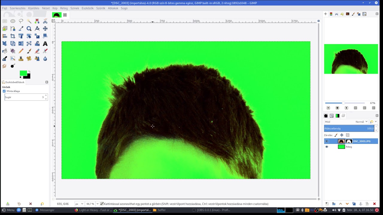

My trickiest trick is probably to use an inverted grayscaled image as mask to itself. This is for background removal for hairs :slight_smile:
Just recorded this for you:
I start here with a cropped image of my son in law. In lack of studio lighting and background he just stood in front of a wall in our living room. I used the “intelligent scissor” to mask him, but this does not work for hairs. This is the trick, that does :slight_smile:
I show here only the hair part.
Note, that from 2:58 I paint on the mask, rather than the image, regardless of the mask itself is visible, or just applied to the image.
