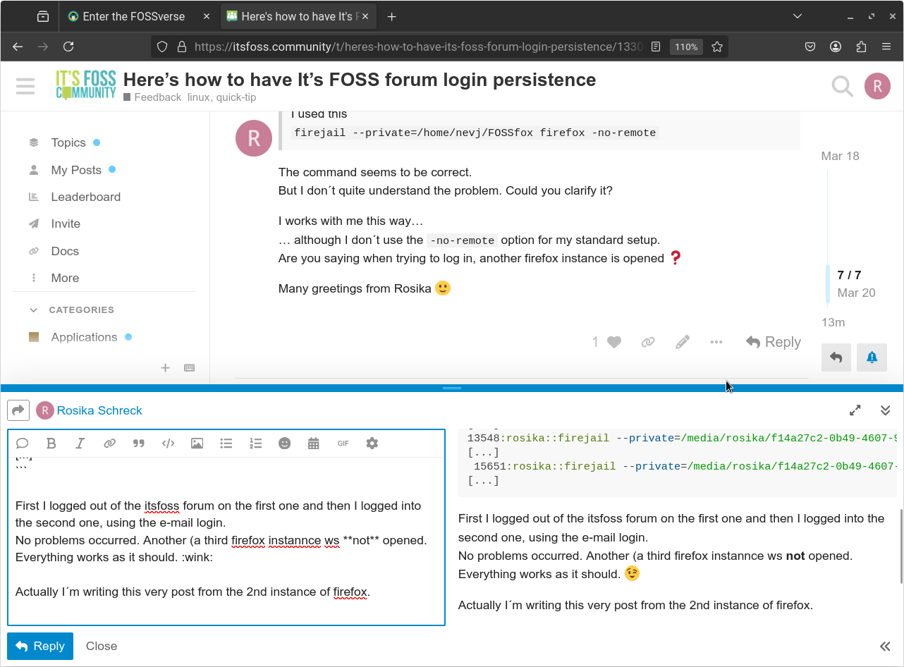

@nevj :
Update:
I just checked:
At present 2 instances of firejailed firefox are running on my system:
firejail --tree
13548:rosika::firejail --private=/media/rosika/f14a27c2-0b49-4607-94ea-2e56bbf76fe1/DATEN-PARTITION/Dokumente/work2 firefox
 15651:rosika::firejail --private=/media/rosika/f14a27c2-0b49-4607-94ea-2e56bbf76fe1/DATEN-PARTITION/Dokumente/prov_work_ksk/ --dns=1.1.1.1 --dns=9.9.9.9 firefox -no-remote https://itsfoss.community/
First I logged out of the itsfoss forum on the first one and then I logged into the second one, using the e-mail login.
No problems occurred. Another (a third) firefox instance was not opened.
Everything works as it should. :wink:
Actually I´m writing this very post from the 2nd instance of firefox.

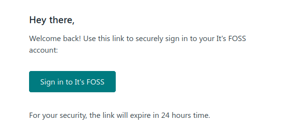

OK, I get it… that green button in thunderbird IS the link
I did not know about using right mouse button.
Thank you, I feel so stupid. Will try tomorrow.

Well Sylpheed is a lot more helpful than Thunderbird.
All I see in Thunderbird is a green button to click.
Here is what I see in Thunderbird
and, you are right, I can copy the link with the right mouse button, or I can drag and drop it.
So now I can put it into the correct instance of firefox. It should persist now… yes it persists, I tested closing the browser.
