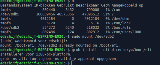

How do I delete Ubuntu 18.04
Check in Ubuntu22
Do a df
You should see something mounted to /boot/efi
If not , you need to find the EFI partition and mount it first.
I assume your machine is a uefi boot?
If it is a legacy boot, it is all different.
I am putting the finishing touch to a legacy boot of Ubuntu 22.04 that is running Ubuntu 22.04 and Windows XP.
That seems OK.
Now do
update-grub
It should find Ubuntu22 and Windows (and Ubuntu18 if you
have not removed it yet)
If it does not find Windows… add the line
GRUB_DISABLE_OS_PROBER=“false”
to the file
/etc/default/grub
and try again.
Neville, I have not removed Ubuntu18 yet, I wanted to do that after the Grub procedure would have worked. I sent part of the monitor output to show that /boot/efi exists. However the last line gave an error (in Dutch) saying "no installation device mentioned¨.
What is meant here?

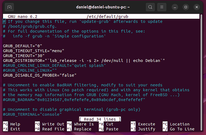

My Ubuntu default grub. All of the grub entries can be edited and saved, this is just one way I boot Ubuntu, if it was Gentoo, then it would be a little different.
Thanks for your input, Daniel! I have the same /etc/default/grub contents.

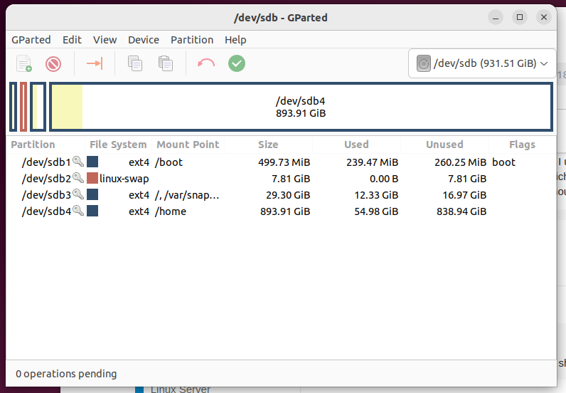

Is your BIOS set to legacy boot?
What I gave you for grub install is for EFI boot
For legacy boot it is
grub-install /dev/sdb
to put it on disk sdb
and you do not need an EFI partition
