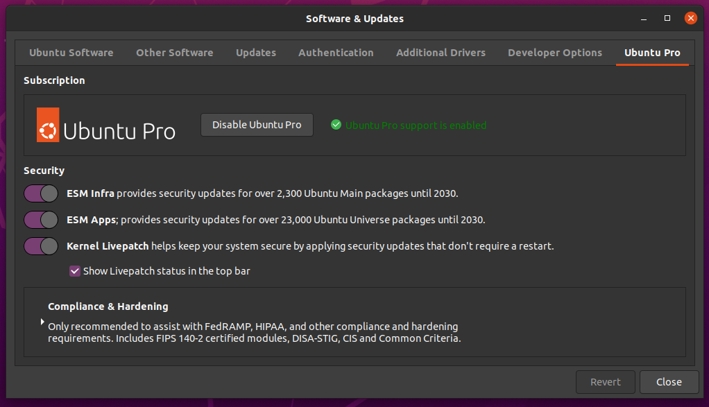

Basically yes!!! I could install my spare AMD card but my Windows XP install has to have the Nvidia GT430 to run the apps I am using. So I will try and get the Pro Ubuntu support and run 20.04 until the machine dies. While Windows 10 will run on the machine, their is really no mobo support for anything above Windows 7. I have to use CTRL+ALT+DEL to boot Windows 10 or Windows 11. I just do not need a full-time Linux machine, three cheers for Linux support for older machines!!!
Got Ubuntu 20.04 on pro support, will see how it goes!!!
What does pro support do?
You seem to suggest it enables you to keep running on an old version?
Another option is run Ubuntu in a VM inside Windows.
It is supposed to extend support for Ubuntu 20.04 to 2030.
That is not an options for this machine.
Ok… so its like LTS
Some distros (eg Gentoo) allow you to run old kernels with the rest of linux (ie stage3) modern. That would work for you too, because the old kernel includes the old driver modules.
It is LTS, but LTS is only good for 5 years, while extended LTS or ESM, as Ubuntu calls it can be had by installing support packages and logging into Ubuntu Pro to get the code to enable live patch. It is free for personal use for up to 5 pc’s.
Not sure about that, I believe Gentoo will put you into kernel version 6, at the get-go.
So as long as Ubuntu 20.04 supports my Nvidia GT430, it is what this machine will run. Have not had a crash since since moving to Ubuntu 20.04 and using Nvidia graphics instead of Nouveau graphics.
