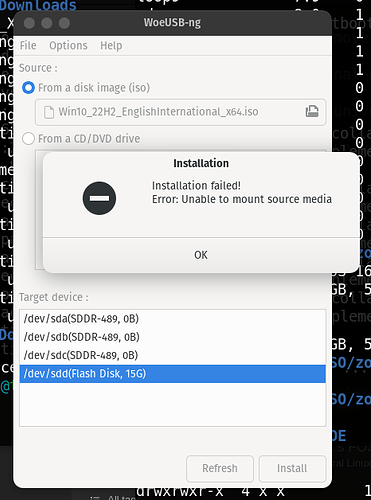

WoeUSB (as a python pip app) is broken :
The first time it happened I thought it was 'cause I was opening an ISO file on my NAS as effectively “root”… So I copy that ISO image to /var/tmp/ on my system - try again… SAME ERROR!
So I exit - try again - SAME ERROR!
So I try again - making sure /dev/sdd is not mounted…
and :
