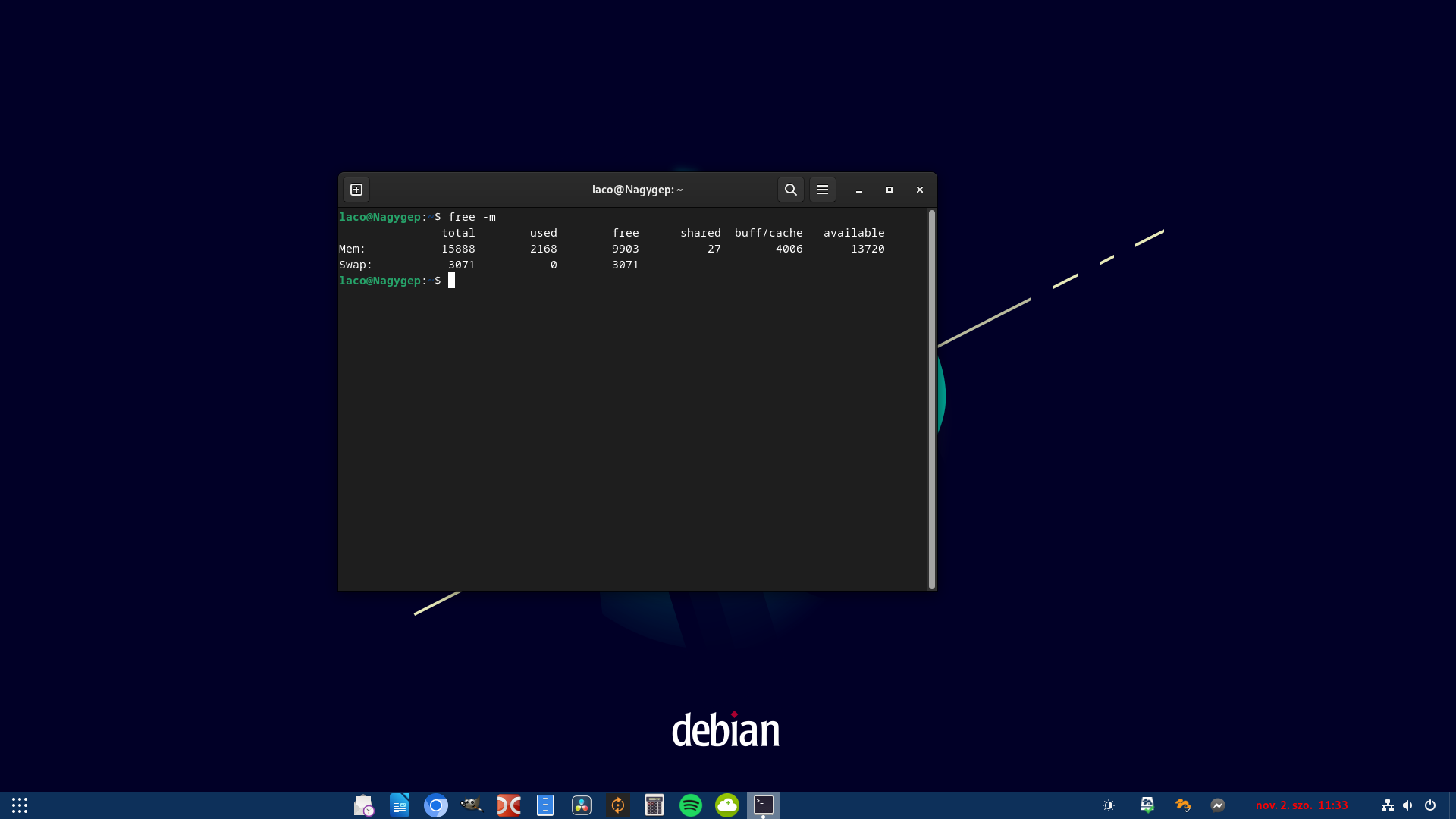

I suspect, you have Fedora with a more demanding DE. maybe?
I would not worry anyway, RAM is there to be used, right?
:slight_smile:

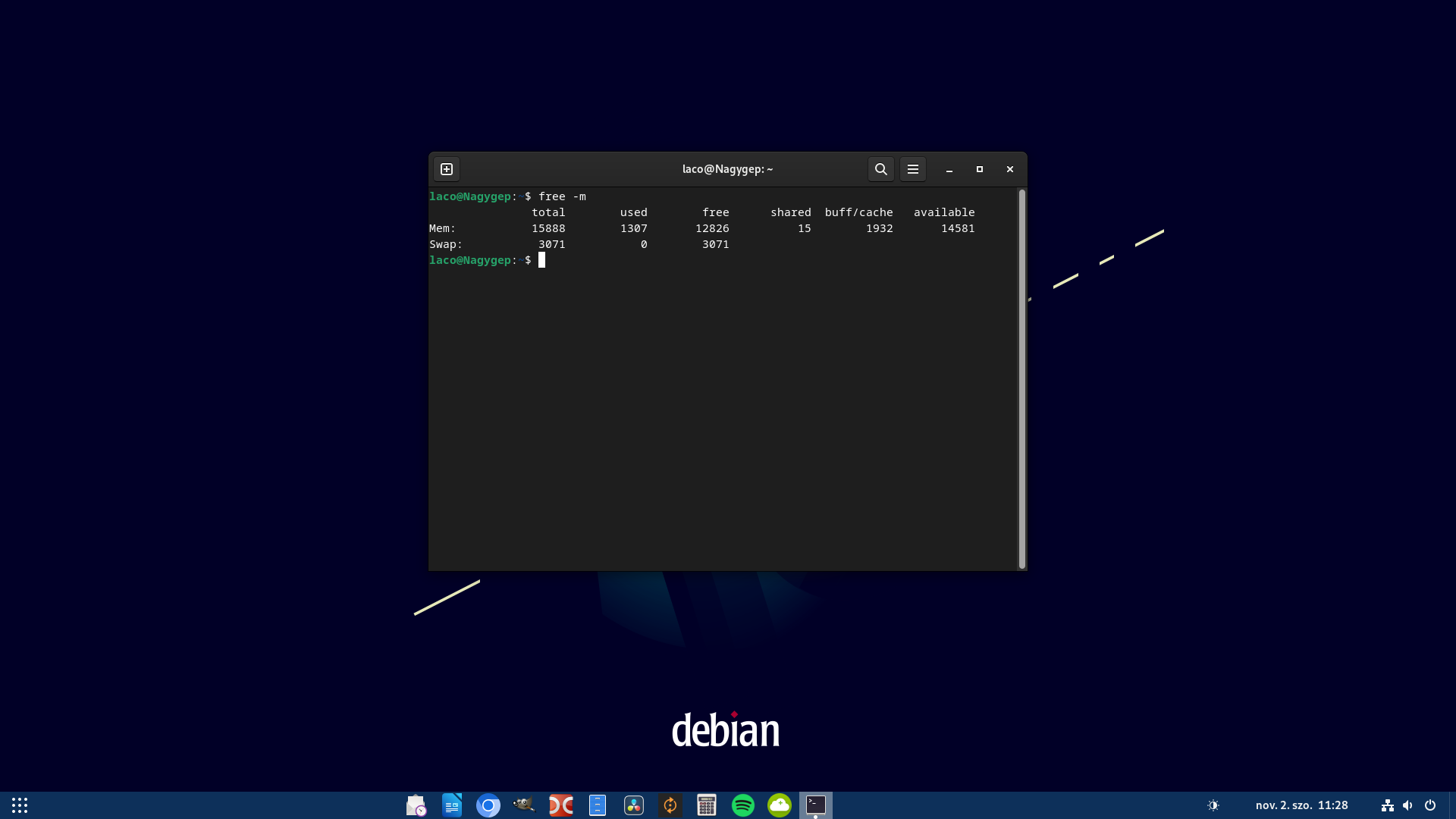

Debian on my desktop with GNOME takes alone ~1.3GB
But it’s always more, as I have some programs auto-started, and they consume too.
So it’s somewhat above 2GB.
Choose what’s best for you!

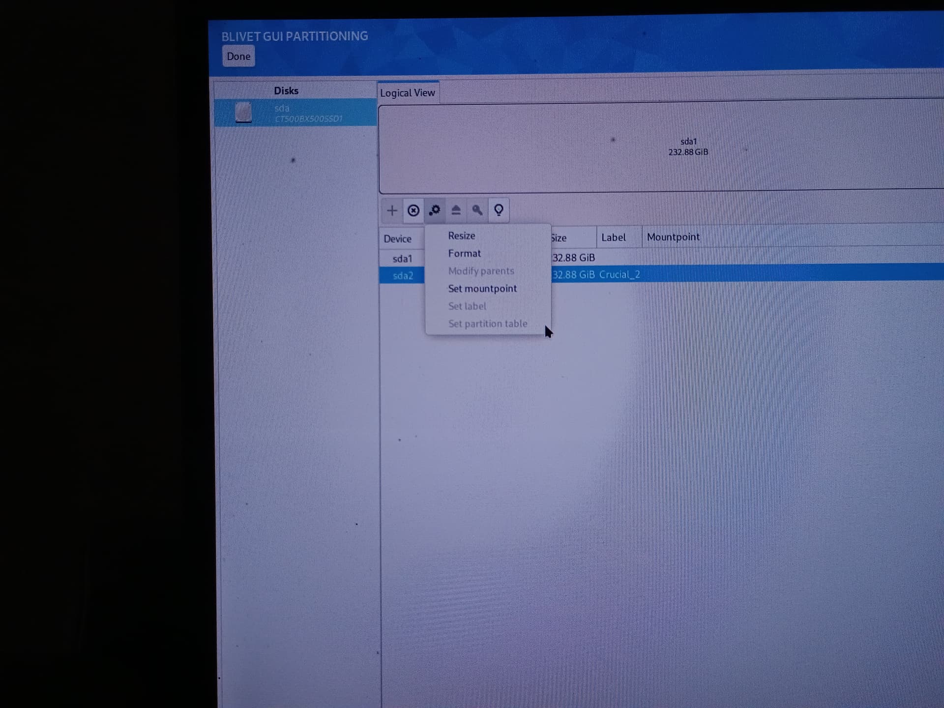

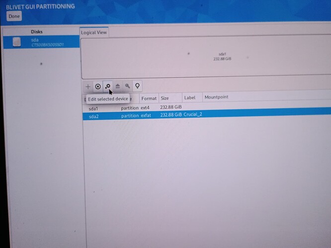

I have just started a fresh dual boot installation of Debian and Fedora. Before doing this, I had deleted all the partition in the disk and then partitoned it into two equal size of 232.88GB partitions using Windows disk management and formatted them in exFAT file system. After that I have installed Debian first using the live USB. No cuatom partition. Now I am installing Fedora 41 using live USB. As I am using Ventoy, on booting from live USB it gave me two choices:
  1. Boot into Normal mode
  2. Boot into Grub2 mode
Though I don’t know anything about the ‘Grub2’ but in the process of searching and learning, somewhere I read that Grub2 gives more choices, I don’t know what they are, though.

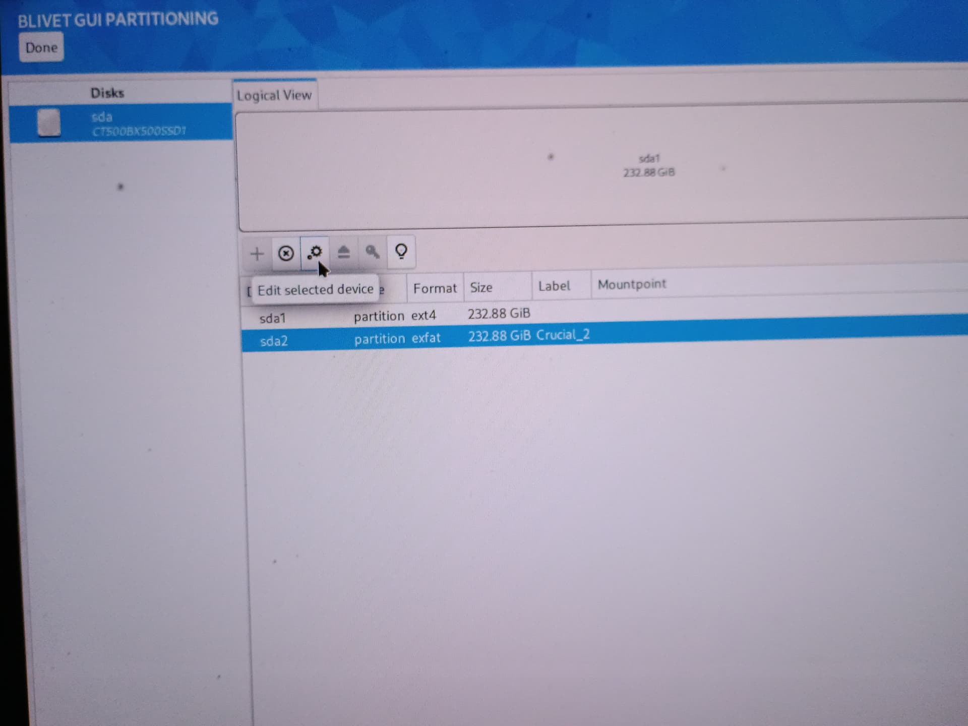

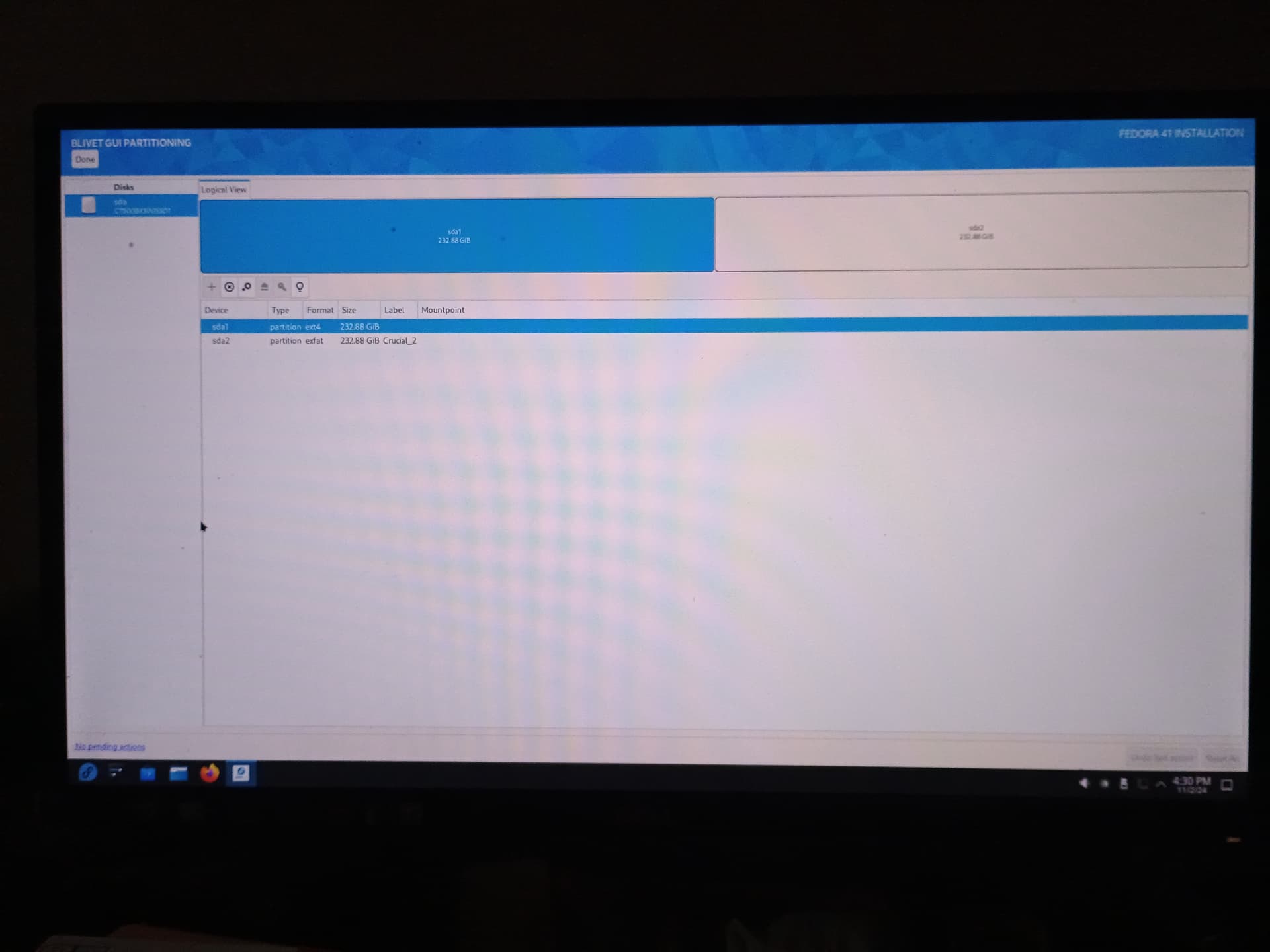

Now tell me what should I do when I am in the ‘INSTALLATION DESTINATION’ page, ‘Custom’ or 'Advanced Custom (Blivet-GUI)?
Update 1: ‘Blivet-GUI’ is a page with a graphical interface. See the picture below
In the ‘sda1’ Debian 12 has been installed but looks like Fedora has not recognised it.
Normal mode: UEFI boot.
Grub2 mode: Legacy (MBR) boot
You shoold boot the installer in the mode you whish to install - most probably UEFI mode = Normal mode.
But for UEFI you are going to need a 3rd partition, EFI system partition, formatted to FAT32, size about 250MB.
Additionally the partition table has to be GPT, not MBR.
I chose ‘Grub2’ mode as I have disabled UEFI in BIOS as I saw when the disk is partitioned under UEFI and GPT, it does not recognise the disks with MBR partition table.

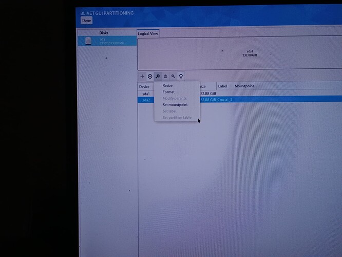

Now, see the below images and let me know what to choose:
1.
2.

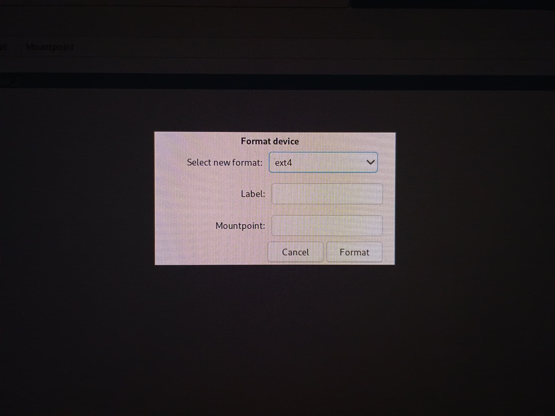

Update 1: When I clicked on ‘Format’ this is showing:
If this is going to be the install destination, I’d choose ext4, mount point needs to be / (root).
