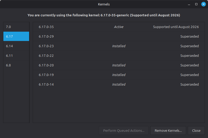

Is it possible to add the Linux Kernels option to the LMDE Update Manager?
It would be nice to have an option similar to
in the LMDE 7 Update Manager…
Is it possible to add it in?

Short answer: No.
The kernel selector is already present, but it’s hidden/disabled by default.
In file /usr/lib/linuxmint/mintUpdate/mintUpdate.py:
try:
	# Only support kernel selection in Linux Mint (not LMDE)
	if not os.path.exists("/usr/share/doc/debian-system-adjustments/copyright"):
		viewSubmenu.append(kernelMenuItem)
	else:
		self.is_lmde = True
except Exception as e:
	print (e)
	print(sys.exc_info()[0])
I’m quite certain there are reasons for that decision. Personally, I didn’t know of this option, nor did I ever miss it.
UPDATE: Out of curiosity, I enabled that kernel panel. The menu entry becomes available, and the kernel panel is shown, but with an empty list. I assume this option is unmaintained in LMDE and therefore hidden.

When I installed LMDE in a VM, I noticed the Update Manager GUI did not have the ‘Linux Kernels’ option under view like Mint Cinnamon has.

The kernel list is not empty on my Linux Mint.

I know, thank you. I was only noting a difference between LMDE and regular Mint. So my post was about regular Mint, yet comparing the 2 different Mint releases.
Did my post help solve or answer the question? No.
Is my post a bit off topic? Yes.
Does my post inform that Mint Cinnamon does have a kernel page? Yes
If you feel my post is improper, you have the option to flag it for consideration of a moderator.
So yes, I read your posts and yes, I know the topic is about LMDE.
