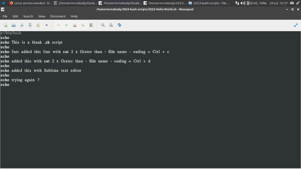

Hi nevj - As it has been so long since I first used itsfoss, I had forgot that it was lesson 1 that I got stuck on, so here is 3 screen grabs of the how far I got - 1 png to each reply - I think we should start afresh - Please treat me as a newbe with your replies, Thank you for your time. John - png 1 the code used -
The file 2023-Hello-World.sh does not have execute permission
ie it should show as rwxrwxr-x in the ls -l output
to fix it do
chmod +x 2023-Hello-World.sh
then check with ls -l again
Then, when you try to run the script, it should run.

Dont give up. You did fine with the screenshots

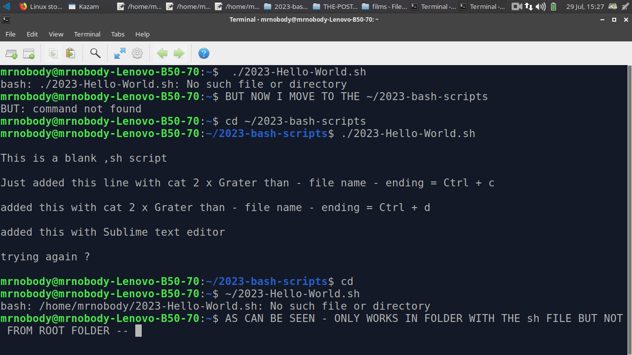

(./2023-Hello-World.sh ) will not execute from root. Executes only from folder with the ( ./2023-Hello-World.sh ) So what code needs to be added to make if open and display the message by clicking the ( 2023-Hello-World.sh ) script ? - See pic 04 -

In Linux, there is a search order the OS looks thru to find the command / program to execute. You can see the search order (path) by typing in “echo $PATH” without the double quotes. If you copy your script to one of these libraries (directories), then the OS will find it. After you copy the script, you may have to make it executable again.
The other option is to make a change to the path. I do not recommend this at this time.
The output of my echo $PATH shows as the last directory /home/easyt/.local/bin which means the library .local/bin belongs to me because it is in my home directory. So if you also have this library and if you copy your script to it and make it executable, then it will work from anywhere.
Only one catch. The library is invisible. The “.” in front of local/bin means a directory or file is invisible. I know how to make a directory visible using the GUI. I believe you can also copy your script to the invisiable directory using the cp command.
That is right. ./ scriptname.sh will executd only from your current directory
To execute it from elsewhere use
`~/scriptname.sh
It is not meant to be run graphically.
It is a command line script
You need to learn about search paths… read Howards reply
I learn something new today. Thank you.
Yeah, you can always use the full pathname
Cheers
