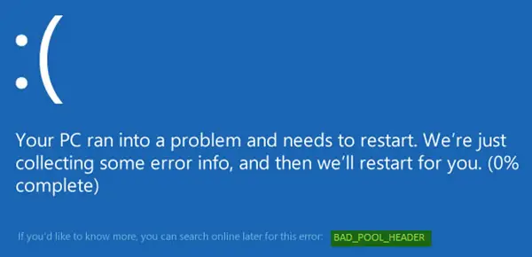

I have another computer that I’m trying to rehab with my new Linux foray. It’s a laptop that is using Windows 7 that shutsdown on boot. Sometimes it shutsdown with the blue screen and sometimes it shutsdown immediately without any screen change. The last BSOD was a BAD POOL ERROR.
