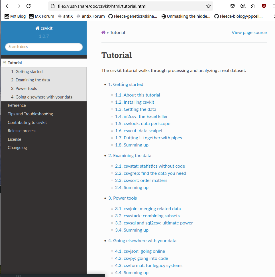

The csvkit commands
There is no general man page for csvkit. There are individualman pages for the utilities listed above… csv2rec, csvvlean, csvcut, csvformat, csvgrep, csvjoin, csvjson, csvlook, csvpy, csvsort, csvsql, csvstack, csvstat, in2csv, pedigree, rec2csv.
There is also an .html document installed by the package csvkit-doc. You can find it here
file:///usr/share/doc/csvkit/html/index.html
It is a comprehensive document, and includes a tutorial
There is no point in my duplicating it here

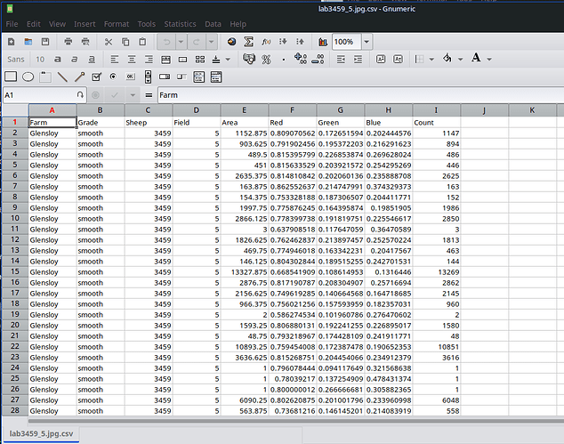

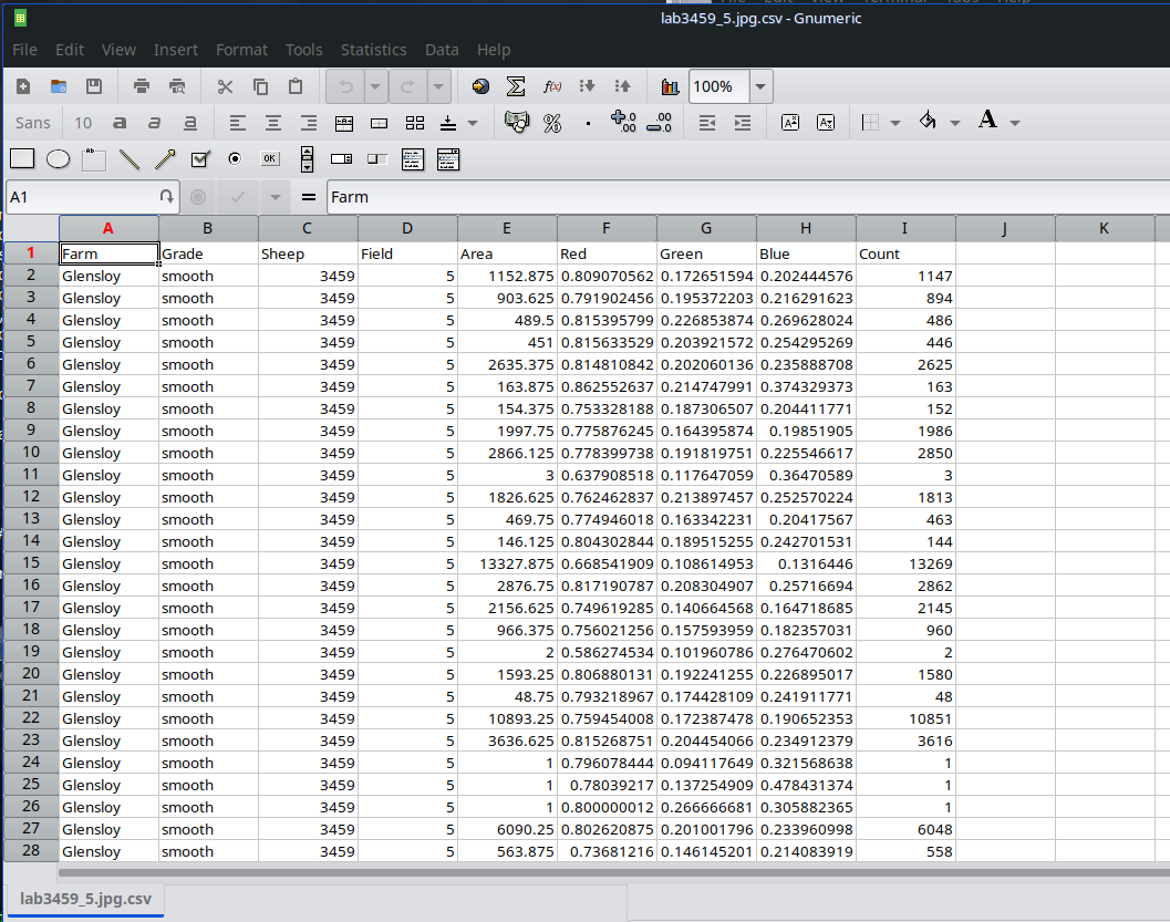

You can also read them into a spreadsheet
$ gnumeric lab3459_5.jpg.csv
Gnumeric is my favorite spreadsheet.

I prefer libre office calc never had a problem and done some really big files and data. So big had to split the file in 2 parts as it would not fit on one sheet
Too many buttons to press. I can start gnumeric from the CLI
Me, too, Paul. A csv file is picked up by calc pretty easily. I can start it with a right click, Nev.
