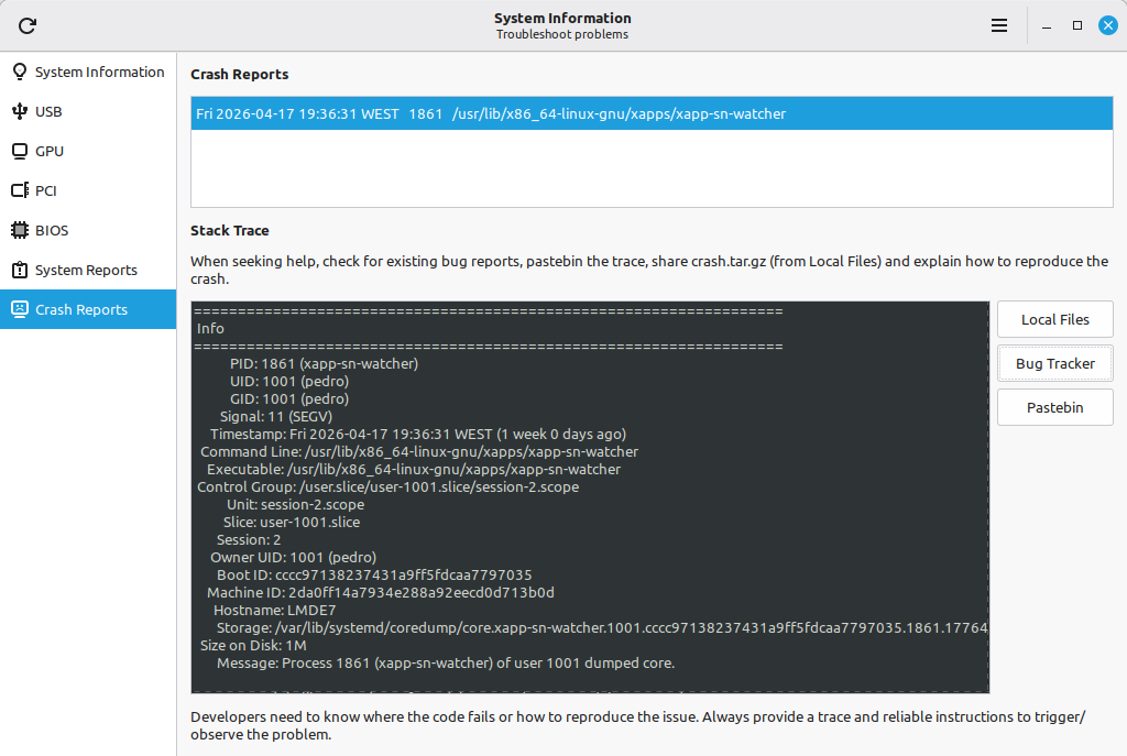

Today while reading and answering to another topic on this forum, suddenly the system froze and did not recover (at least within 10 minutes…)
Looking for Crash reports I only found the report for a previous lock
Curiously, clicking on “Bug tracker” leads to a 404
https://github.com/linuxmint/libxapp1/issues
And clicking on “Pastebin” does nothing (I assume it should open a tab in Firefox and paste the log on pastebin. com or similar?)
It did create a crash.tar.gz file in the /tmp/mintreport but I have no idea what to look for…
Can I upload it somewhere for you (itsfoss.community experts) to take a look?

That crash.tar.gz file contains a coredump and system info. It is unlikely to be useful.

I downloaded the crash.tar.gz file, extracted it, then uploaded to Copilot to see what it thought.
It looks like something from Cinnamon notifications caused this problem. Maybe an update is available for that?
Short version: this is a user‑space crash of a Cinnamon/XApp helper, not a kernel or driver blow‑up.
From your stack trace:
Process 1861 (xapp-sn-watcher) of user 1001 dumped core.
Program terminated with signal SIGSEGV, Segmentation fault.
Core was generated by `/usr/lib/x86_64-linux-gnu/xapps/xapp-sn-watcher’.
#0 0x00007f2599111fc5 in g_dbus_proxy_get_name () from /lib/x86_64-linux-gnu/libgio-2.0.so.0
