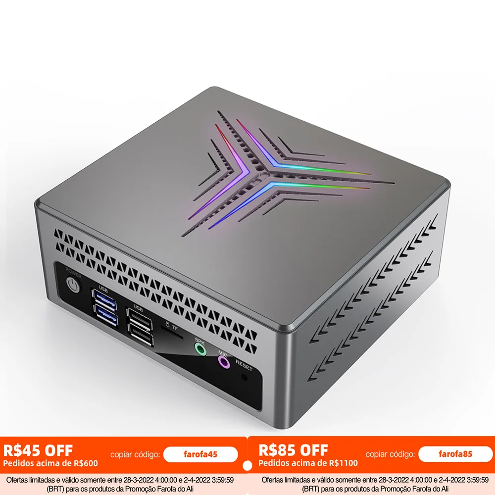

Yes, it is MBR partition table with legacy (no UEFI) boot. I don’t feel like reinstalling everything now, but I found a cheap Jasper Lake Intel Celeron N5095 mini PC on Aliexpress, which I plan to buy and use GPT and UEFI boot.
Cheers

PS Looked at Aliexpress. Seems a good buy. I bought a secondhand Dell with similar specs and about same price. Check it has ports you need, mine had no builtin wireless.

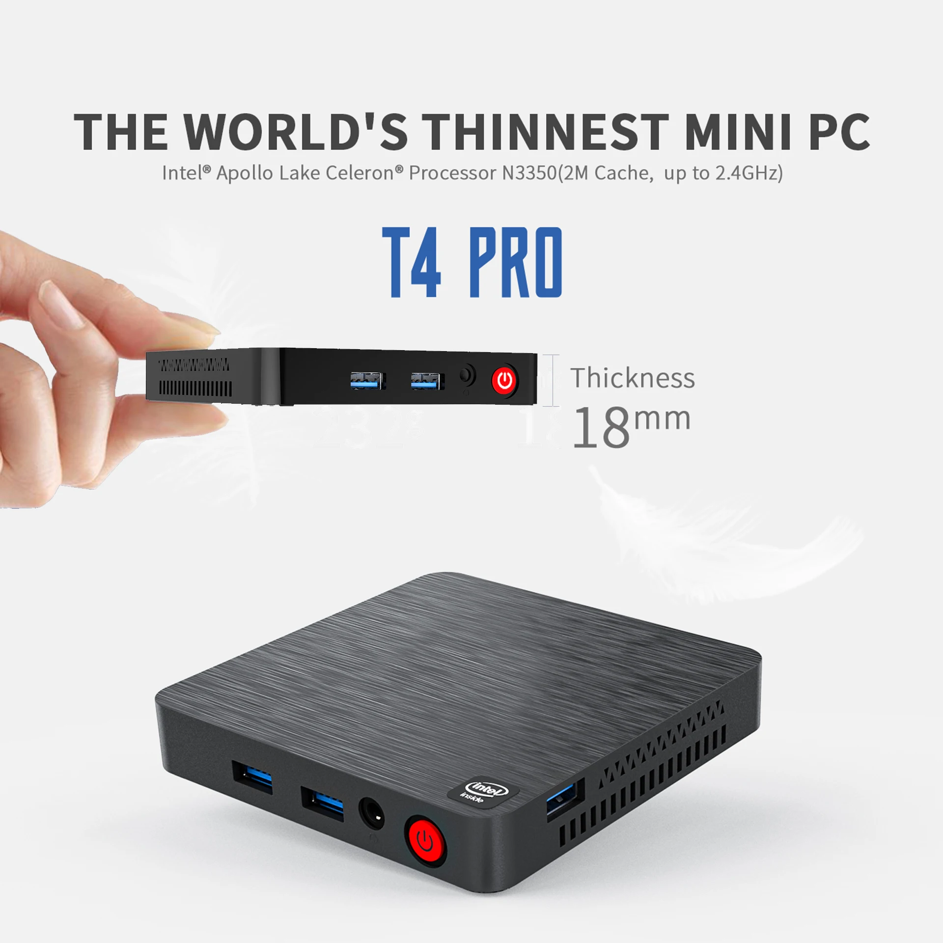

I want to use only UEFI boot in my new system with GPT table on SSD. The mini PC I plan to buy is a barebone (case, power adapter, motherboard and CPU soldered to the motherboard). The barebone always shipped without RAM, SSD and WiFi adapter. I use Ethernet, so no need for wireless and already have an SSD and DDR4 SODIMM RAM. Barebone is always a better deal since the sellers always overcharge for RAM and SSD. Here are even cheaper mini PCs that use an older and less powerful Apollo Lake CPU N3350, but also include LPDDR3 4GB RAM + 64GB eMMC + 2.4GHz & 5GHz dual band WiFi + Licensed Windows 10.
N3350 is a 6 Watt Mobile CPU, which includes integrated Intel HD Graphics 500 and powerful enough for Internet, office and multimedia - HTPC.
