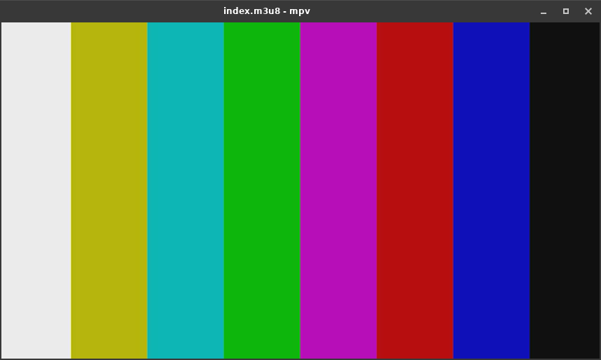

I used the URL http://ott-cdn.ucom.am/s24/index.m3u8 for getting the BBC News TV stream.
Using it with mpv proved to be working well but I noticed a recurring strange pattern:
At more or less the same time (around 3:45 pm Central European summer time = 1:45 pm UTC) the curent programme gets cut off.
The exact time may vary by a few minutes plus or minus. But the cut off happens pretty much at the same time every day,
  • Sound is chopped. Totally distorted. Not intellegible any more
  • Video stream is cut off altogether and it´s replaced by a standard colour bar test picture:
  • This situation lasts for about 2 minutes
  • After that everything´s back to normal again

Hi @Rosika ,
I think they are probably switching between devices.
Our free to air TV does it regularly.
2 mins is a bit short to be considered an interruption to 24/7

Hi again, :waving_hand:
thanks a lot for your replies.
@nevj :
Ah, I see. Well, that could be it.
Well, if that is the case they do a pretty lousy job, right?
In the middle of the programme, instead at the end of it.
The last few minutes of a programme is normally taken up by short trailers of future stuff. That would be a better timeslot for things like that.
Besides the chopped audio sound seems awkward. They should switch the audio stream off altogether for the duration of those 2 minutes. :thinking:
O.K., that´s good to know, Neville. Thanks for letting me know.

That sounds a bit strange. There may be another explanation.
yes, it´s a bit strange.
I´ll check it again today, just to make sure that the interruption of the programme indeed happens at the same time each day.
I wonder if it has anything to do with the fact that the website, or rather URL, is hosted in Yerevan. :thinking:
See my post #5.
Does it mean that that the server is running from that location :red_question_mark:
I don´t know enough about the background.
Yes, I think so.
Maybe they stop for prayers in Armenia.
thanks for the confirmation.
Seems your suggestion:
is indeed the most probable explanation.

I´m happy to report that I finally could solve the initial problem I described in my thread #1.
A short recap:
[00007f0600001610] http stream error: error: HTTP/1.1 403 Forbidden
  • Spoofing vlc´s user agent didn´t work either:
    vlc --http-user-agent="Mozilla/5.0 (compatible; mpv)" http://ott-cdn.ucom.am/s24/index.m3u8
  • freetuxtv uses vlc under the hood, so the problem is also apparent here.
I finally managed to play the stream with vlc as well:
In order to achieve this goal I created an .m3u playlist with:
  • An #EXTVLCOPT:http-user-agent=... line to spoof a browser User-Agent. # that´s the important bit
  • The stream URL.
I obtained the information from https://github.com/Alstruit/iptv2/blob/master/streams/am_ucom.m3u:
#EXTINF:-1 tvg-id="BBCNewsEurope.uk" http-user-agent="Mozilla/5.0 (iPhone; CPU iPhone OS 12_2 like Mac OS X) AppleWebKit/605.1.15 (KHTML,like Gecko) Mobile/15E148",BBC World News (480p) [Not 24/7]
#EXTVLCOPT:http-user-agent=Mozilla/5.0 (iPhone; CPU iPhone OS 12_2 like Mac OS X) AppleWebKit/605.1.15 (KHTML,like Gecko) Mobile/15E148
I then launched vlc like this (from within the folder where the file resides):
firejail --disable-mnt --private=$(pwd) vlc play.m3u
Why This Works:
  • VLC parses the playlist file and respects the EXTVLCOPT options.
  • My research showed that using a mobile Safari user agent (iPhone OS) is often more “trusted” by streaming services.
  • Firejail ensures isolation (just in case the stream was doing something sketchy). :wink:
Having ascertained that this method proved to be successful I then
created a file “BBC_News_TV.m3u” and added it to freetuxtv´s group list.
The files´s contents: the same as before with vlc.
And freetuxtv does indeed play the BBC stream now. :+1:
Finally it works. :blush:
