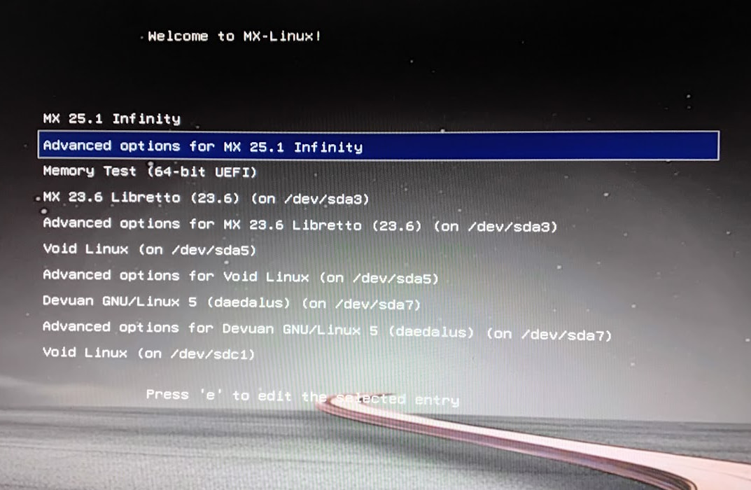

Here is my grub menu controlled by an MX25 sysvinit install
You can see the familiar 2 lines labelled MX 25.1 at the top.
If I choose the first line , I boot MX with the sysVinit init system.
If I choose the second line I get the Advanced submenu

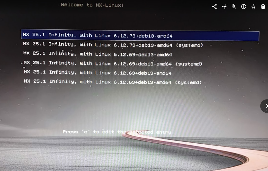

and you can see that I have 3 kernels, and for each kernel I can choose the first line and get sysVinit, or I can choose the second line and get systemd.

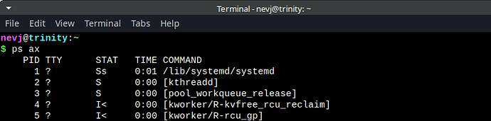

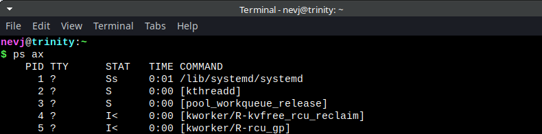

I tested the systemd boot. When It booted I got the following
so the first process is systemd.
When I boot the default , the first process is init … ie sysVinit is the init system.
