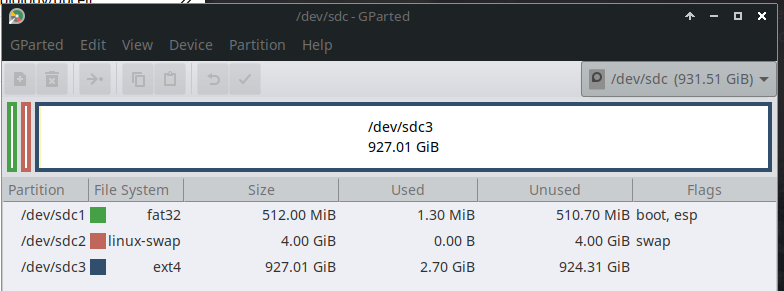

That ‘whole disk’ install is simple . It made partitions as follows
It used GPT partitioning.

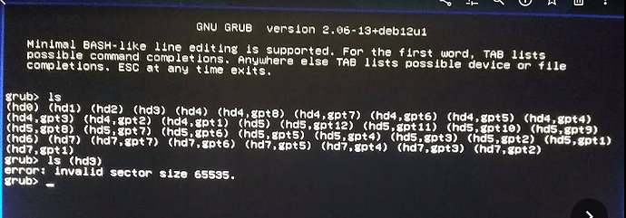

Grub does not see the partitions on the hotplug disk? ie it sees (hd3) but not (hd3,gpt1) etc
I have done insmod part_gpt
What else can I try?

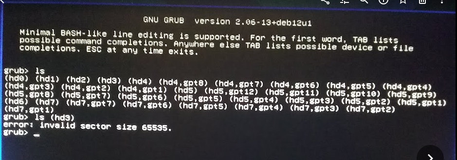

Here is what grub sees
The disks (hd0) to (hd3) are hotplugable… grub can not see the partitions
The disks (hd4), (hd5), (hd7) are internal disks… grub can see partitons on those
I dont know what (hd6) is , but grub cant see its partitons.

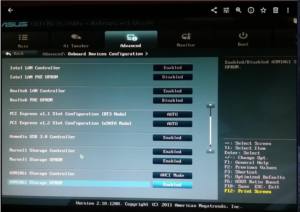

Solved:
There is a BIOS setting which enables or disables scanning of the hotplug disks on the ASM1061 controller. I had it disabled, because that speeds up the boot. If I enable it, the BIOS detects my 2 hotplug disks, and I can boot Alpine from the hotplug HDD containig Alpine.
Strangely, grub can still not see the partitons on the hotplug disks… doesnt matter, it boots the contents OK.
That highlighted setting at the bottom.
I think some BIOS’s call it ‘Fast Boot’
There is also an OPROM for the Marvell interface. I would not want to disable that as it runs one of my internal disks.
