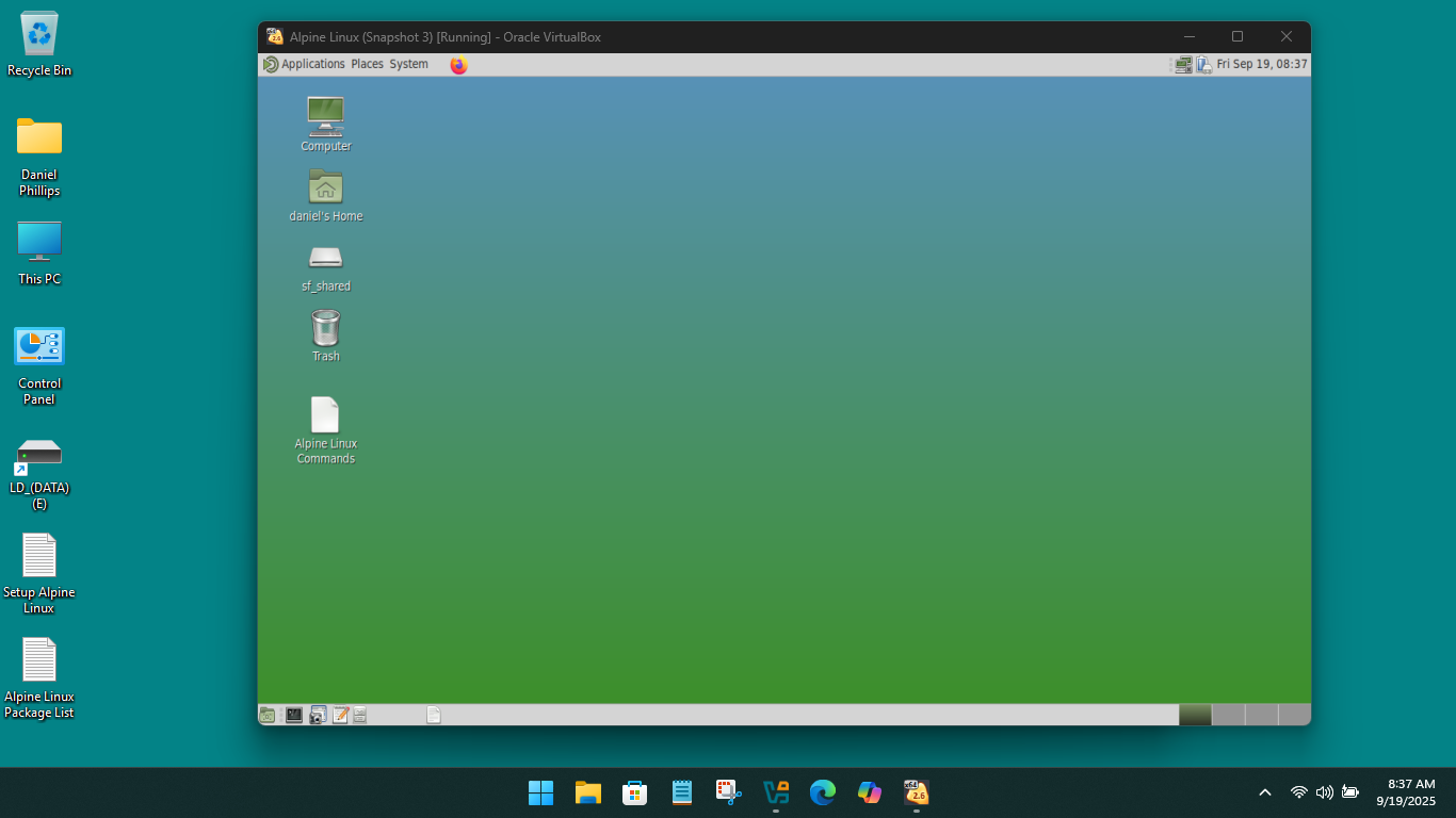

Can you tell me what is in /etc/polkit-1/rules.d in your Alpine install?
It is an even more minimal install for VirtualBox!!!
My Alpine Linux VM!!!
I will have a look-see!!!
Maybe install Mate and try if it works. Then it’s a Xfce bug

Their is no “/etc/polkit-1/rules.d” in my Alpine VM, which does not surprise me!!! I think you should be asking as to why “busybox” does not execute the commands you are in need of!!!
Yes, mine had none to start with too
Yours is a VM… that means you cant test if it will mount a partition.
Yes, that is a possible cause of trouble.
What login manager do you have? Mine is lightdm.
With VirtualBox I mostly just save and set snapshots!!! I am using lxdm!!!
