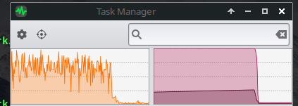

Need more memory ... swapping
Have you seen this?
Memory 100% (62.5GiB/62.8GiB)
Swap 19% ((57.3GiB/293.0GiB)
That’s right, I was running an R process multiplying several large matrices. It filled ram and started swapping. Everything slowed.
I had to kill it.
The task manager looked as follows
That was just after I killed it.
The memory was full and the swap space used was slowly growing
So my 64Gb of physical ram was not nearly enough .
