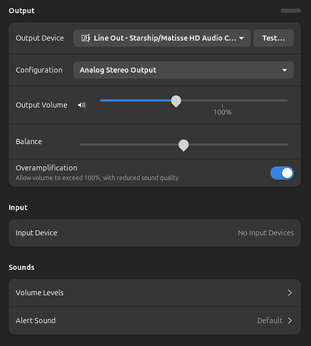

So, I’ve gotten myself a fresh install of Linux Mint. Wifi connects, monitor connects, but not the audio through the external speakers (mini-jack connector).
I’ve tried searching for the stuff I needed (according to AI a simple install) in the Mint repositories, but no luck.
So, I do get sound (on a very low volume, mind) from my monitor (through HDMI), but not through my regular speakers which I normally use for sound (and have a much better sound quality).
The external speakers receive power through the power socket in the wall. They work.
It is connected to the correct port (there’s only one port where it fits, and that’s the headphone jack port).
Possible to use bluetooth connection or not available ?
I have a bluetooth headset, but it’s linked to my phone.
If you disconn3ct it and connect to your new computer does the sound ply ok through that

Strange - that looks nearly the same as mine (on Ubuntu 24.04) :
Audio:
  Device-1: AMD Navi 21/23 HDMI/DP Audio driver: snd_hda_intel
  Device-2: AMD Starship/Matisse HD Audio driver: snd_hda_intel
  API: ALSA v: k6.14.0-33-generic status: kernel-api
  Server-1: PipeWire v: 1.0.5 status: active
Except your version of PipeWire is somewhat newer / updated than mine…
In the Gnome Settings applet - “Sound” : I choose “Device-2” - i.e. my motherboard’s audio jacks :
“Line Out - Starship/Matisse HD Audio…”
Everytime I move the plugs out of my PC if I want to work on it - e.g. recently changed CPU Fan and Heatsink - I can never remember which 3.5mm jack to (there’s 6!) to plug my headphones into… I do have some Logitech 5.1 speakers - but I never use them…
But when I get the correct jack - it just works… I’ve tried the HDMI / Displayport audio (with headphones in my monitor - none of my monitors have speakers) the sound was pretty awful, and got infrequent stutters… So - I’m analog between my PC motherboard and my headphones… I prefer that… My headphones are BT - but I prefer to use them wired…
