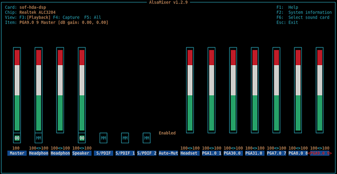

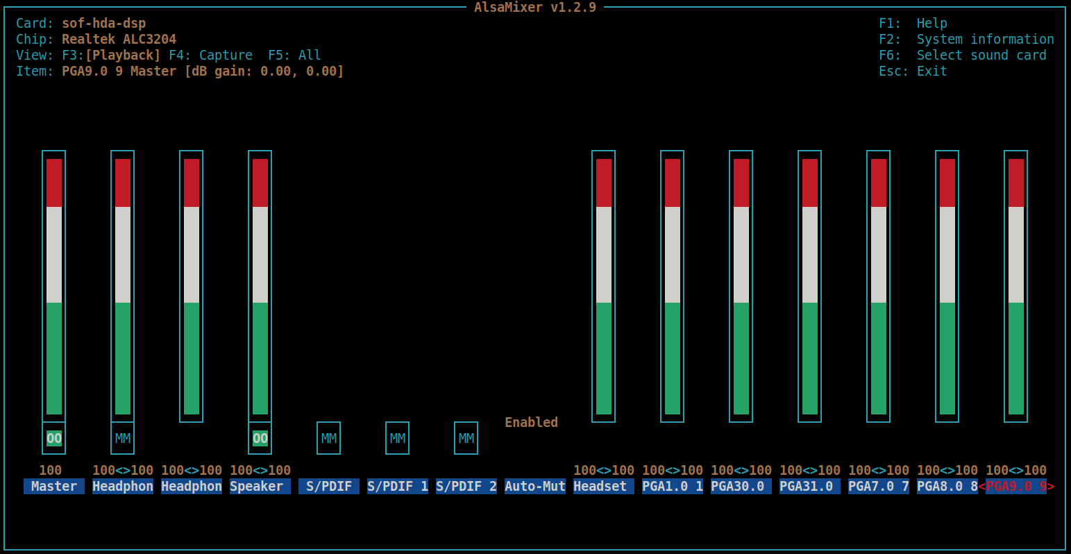

It happened again. This time I took note of exactly when it happened. I was docked via a USB-C dock and sound worked fine. Then I just disconnected and went upstairs and no sound. I docked again and there was sound. So, I shutdown while docked, undocked, went upstairs again, and no sound. Then I tried the headphone jack, no sound. Then I tried bluetooth, no sound.
So, I asked Copilot. The second suggestion was to look in Alsamixer. I started turning up the volume on each device in turn.
The one labeled PGA30.0 did the trick.
This audio business is a black art.
