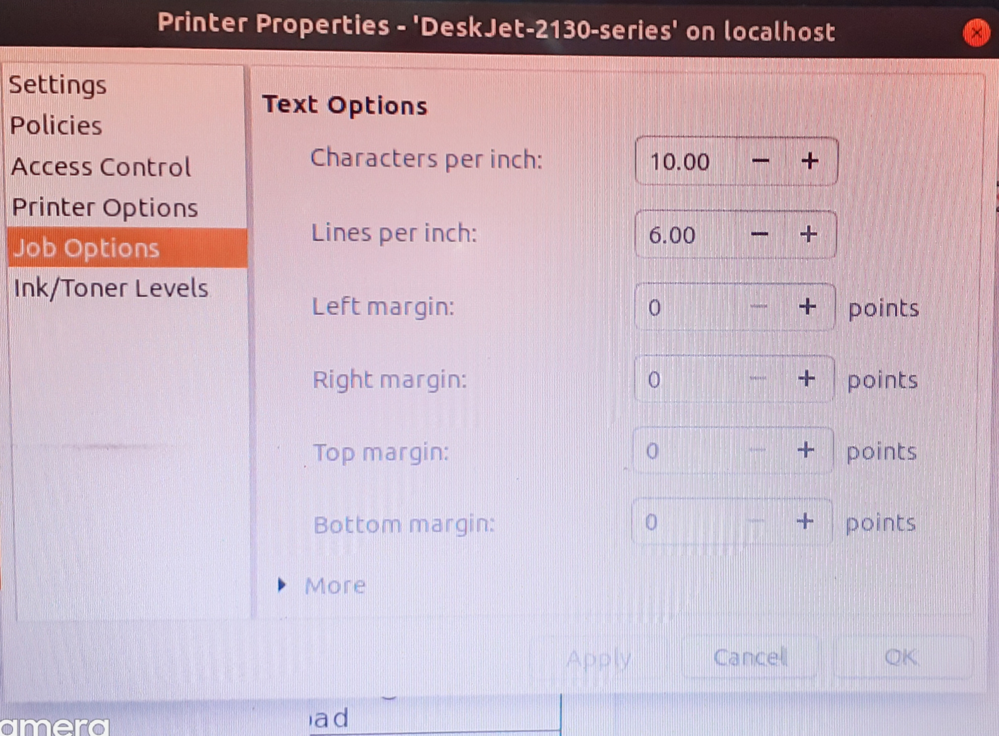

I am uploading a self-explanatory snapshot for a HP 2131 Printer, in which the unit of measurement for MARGINS (Left, Right, Top and Bottom) is on display in “Points”. My query was whether the same could be altered through the Linux command line for display in
millimeters or inches. Python programming code using “Points” as a metric for measurement was my contention.But that doesn’t the answer where Python gets the functionality from. It certainly is not part of the stdlib.

Ok, I think I have a handle on this now. Thanks for the screenshot, it was helpful.
Not entirely accurate. What your screenshot shows is a configuration interface to the printer definition, that lets you customize the dimensions of the legacy Text Mode output. The units are in points because those are the units used in the .PPD
file that contains the printer configuration, and the interface you’re looking at is extremely low-level.
It will also have no effect unless you’re using the printer in legacy line printer mode (text-only), which trust me, you are not. Even if you print text-only documents, you’ll be printing them rendered to PostScript or PDF document. The interface you’re looking at is not intended to be used… well, period, really, these days. It’s from 30 years ago. Literally.
Afraid not, the fact that the config tool happens to be implemented in Python is immaterial. The issue is the PPD data being generated.

It was basically an error in my understanding; when I was in the process of setting up a page with non-standard margins (i.e; NOT, standard 1’’ on all four sides of the media/paper A4 size), the window (wrong ‘interface’ of Frank’s message) as shown in my earlier snapshot opened. I got puzzled when I saw “points” as the metric, and for a moment I couldn’t perceive how to set a margin of 6" from the top, which was my requirement for printing (in Windows, it used to be direct access to the margins set up) then. That is when I posed the query on the forum.
I got the clue, in fact, from your last post, where you cited ‘say, Kate’ as your text editor. Snapshot of my text editor (No Kate like name thogh), which I dug up eventually, has the caption: “Page Style: Default Style” is reproduced below:20201006_Default_Page_PrintEditor|690x494
I wrongly perceived the issue to be a back-end code problem, whereas it was actually a case of Libre Office user-end formatting exercise. Sorry for the inconvenience, once again.
