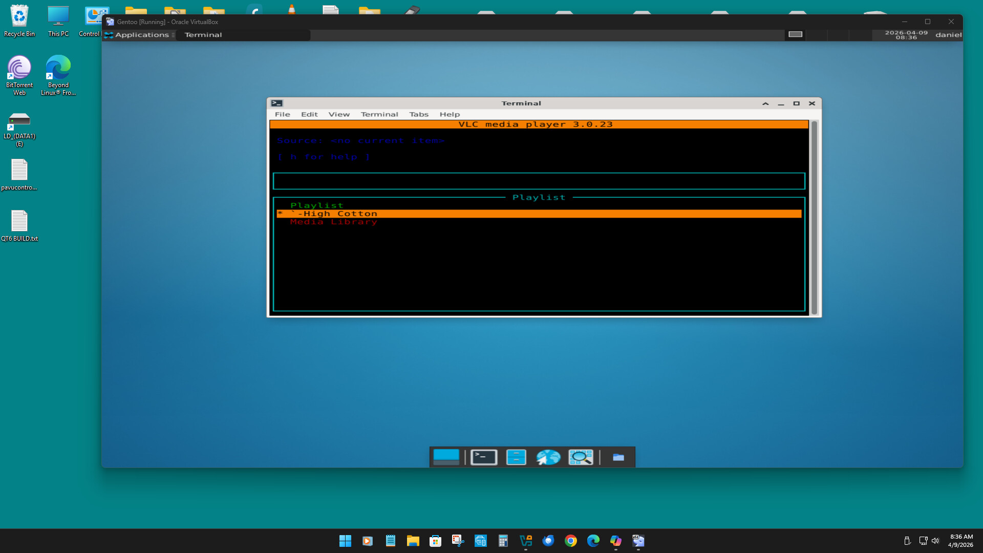

Have to have qt6 to get the GUI for the VLC/XFCE DE, so I used the “vlc -I ncurses” command for the CLI for and a “ B “ to navigate “ enter “ to the “ OGG “ file I wish to play !! You also have to have “ CONFIG_SND__HDA_INTEL=y and the CONFIG_SND_HDA_GENERIC=y “ for LFS VirtualBox to play audio, and virtualbox has to be set to “ intel hd “
It is VLC that nees qt. Xfce uses GTK.
If you used Celluloid/mpv, or MPV alone, instead of vlc, you could get away without qt.
Yes, I know, both are working now, but is it worth the trouble to give VLC a GUI !!! I like VLC because it plays my mp4 video files!!

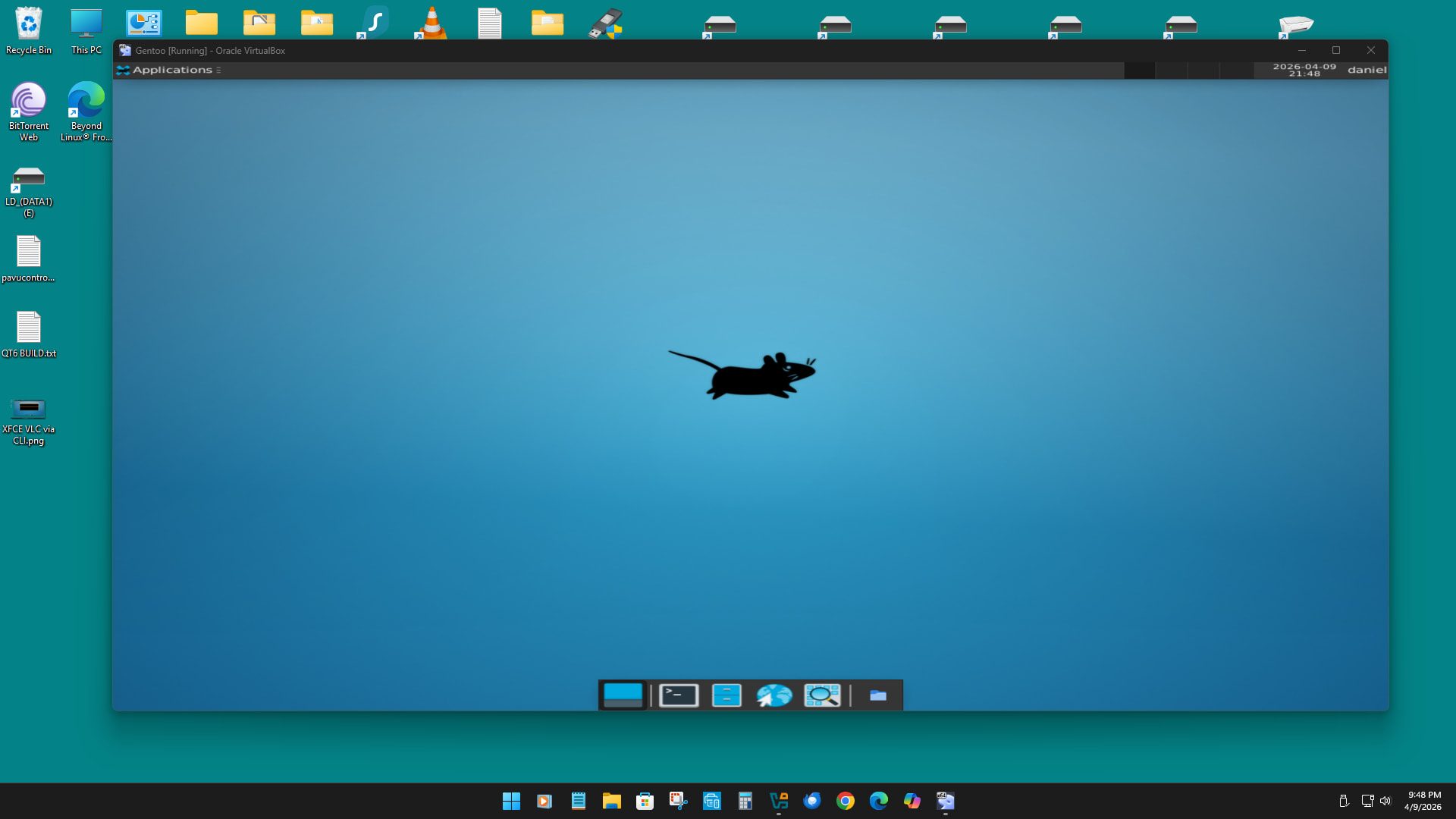

My journey with LinuxFromScratch has finally succeeded with a VirtualBox VM running XFCE!!I first installed a Gentoo VM and used it for the host to build LFS, with Gentoo and LFS on separate VDI’s and booting LFS with Gentoo grub!! While the base LFS, is not that hard to build, taking LFS into the minefield, called BLFS, can be, intimidating, to say the least!! For any Linux user, that wants something, that is not the product of someone else’s labor, then build your own Linux!! It is doable!!!

Close W11 is the host for VirtualBox!!! You set up VirtualBox with two VDI’s and they become /sda and /sdb, you install Gentoo on /sda, with the sys-kernel/gentoo-sources kernel and do a manual kernel config!! Why, because the sys-kernel/gentoo/sources does not drag in what isn’t needed, and you can make sure, the needed tools to build LFS are built in the Gentoo kernel!!
Once Gentoo is built you mount /sdb as /mnt/lfs and partition /sdb !! I now have /sources dir with 94 packages, to build the LFS base and /sources/BLFS dir, with 356 packages for building LFS, for what it is now!!
W11 is also used to ssh into LFS, to give me copy and paste for commands to build LFS!!

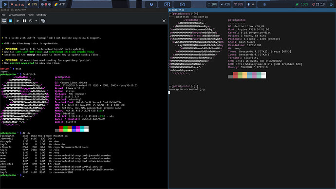

Daniel, look what you made me do… (left is a vm and right my laptop)

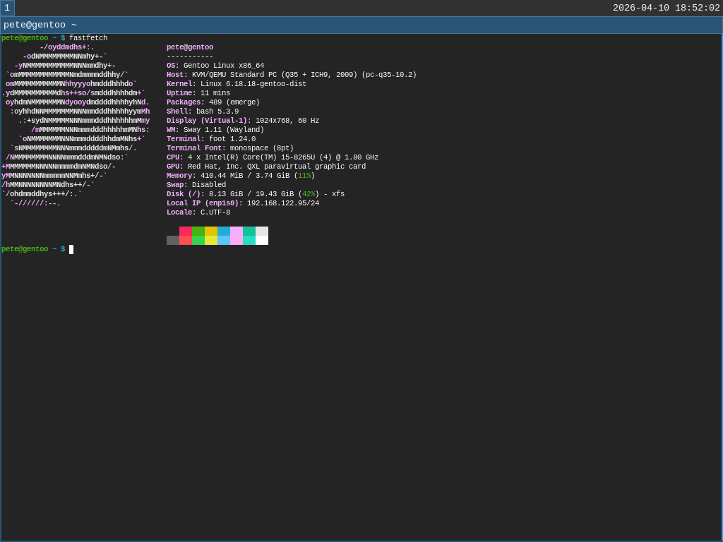

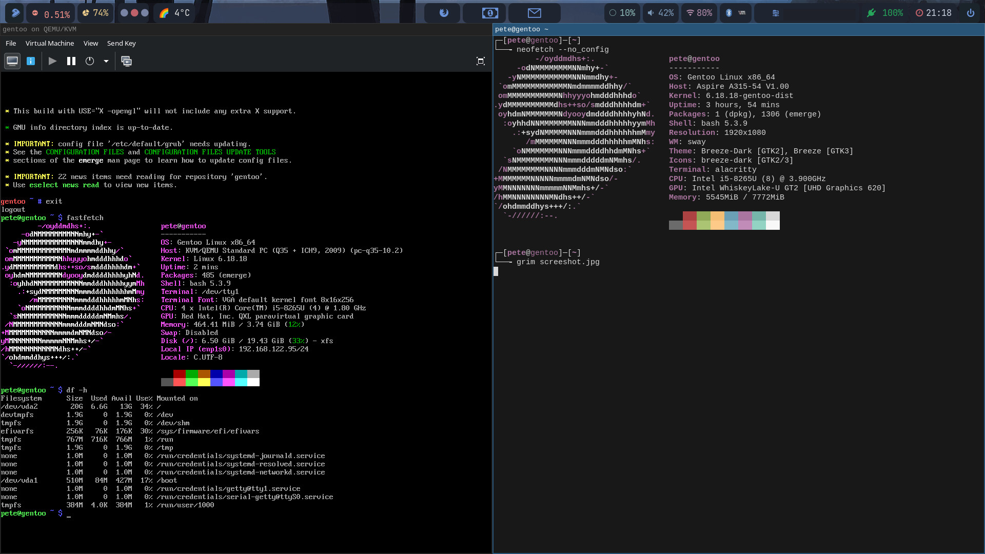

Yes, I made a Gentoo VM inside my Gentoo to try to build LFS. I just can’t get the copy + paste from host to vm to work. So I now try to make a window manager (Sway) for my virtual Gentoo so I can open a browser to read the LFS handbook.
Edit: Sway is now running. Needed to modify the make.conf, add VIDEO_CARDS=”intel” and then re-emerge the linux-firmware and gentoo-kernel-bin
Here’s a screenshot
If you have Gentoo installed, why not just make a partition and mount it as /mnt/lfs!! I know KVM/QEMU will work for LFS, but I mostly use Windows 11 and virtualbox!!
