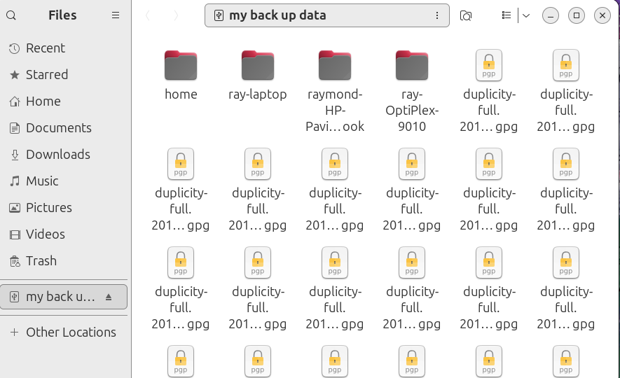

So you opened deja dup on the new machine, and I assume that is a usb flash drive with your backups on it. You chose restore and navigated to the backup you wish to restore and received what error message(s)?
It looks like you have several full backups, but I do not see any incremental ones, at least in the screenshot.

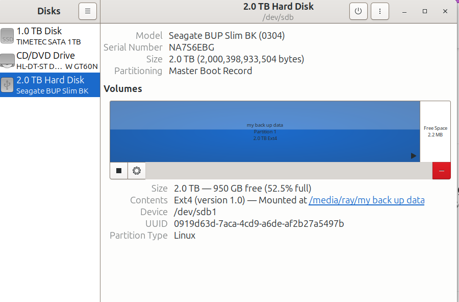

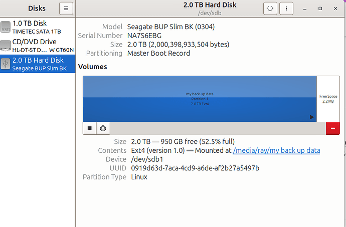

Hi Sheila, I really donāt know much about backups, I used deja dup because that,s what was in ubuntu. the second screenshot is the content of the 2tb seagate external HDD when it,s plugged into a USB on the new pc.I followed instructions to recoup the home folder but I really donāt know what Iām doing hence my quest for info.

Is the backup disk mounted?
You can look with df or lsblk to see if there is a mount.
or
you may have to tell dejadup which disk to look at

The OS can see the files, but dejadup can not see them?.. therefore the problem is in dejadup, not in the new OS, or on the disk.
Hang on, is that the case. Can your file manager see the files on the backup disk?
We need to know that first⦠if the file manager cant see them, the problem is in the new OS or on the disk

You can use gparted to reformat the partitions on the Seagate.
The Seagate has to be unmounted when you use gparted.
Be careful you dont accidentally reformat the wrong disk when using gparted.
