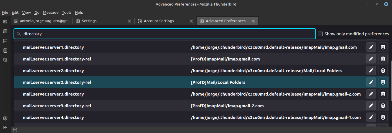

This is my ~/.thunderbird folder:
My profiles.ini:
And these are my settings seen in Thunderbird: menu → Edit → Settings → Thunderbird Settings → Config Editor and searching for the word “directory”:
