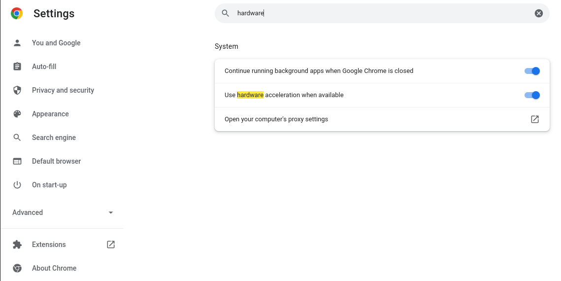

Sorry - glossed over most of the posts here - one thing I’ve had to do in the past occasionally, in Chrome (google chrome - and - Chromium) is chrome://settings and find advanced, and uncheck “hardware acceleration” - have you tried that?
They seem to have obfuscated it now - I had to search for it :
