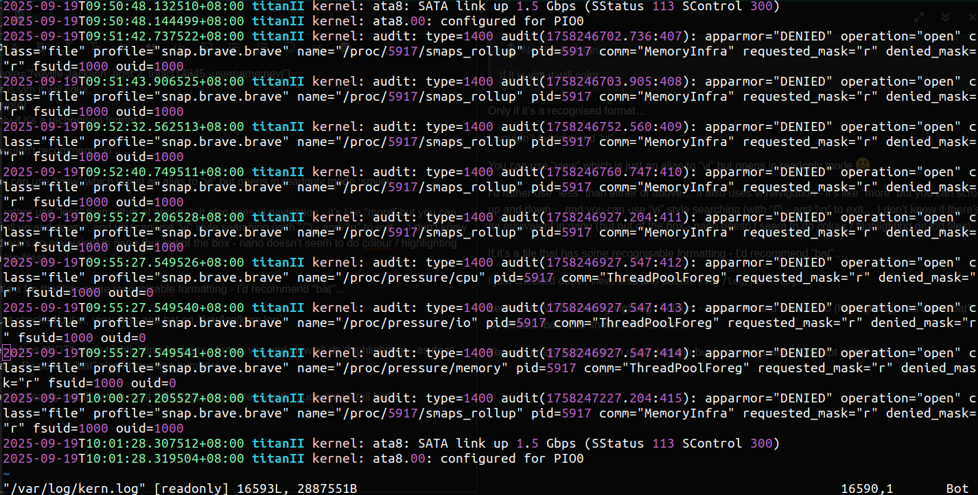

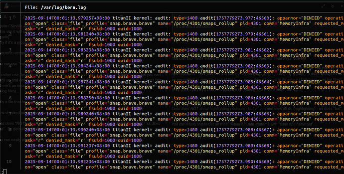

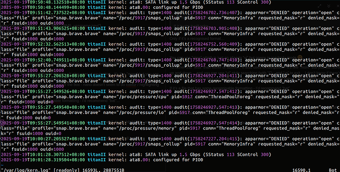

I just checked out vi, view, less and bat on /var/log/kern.log
Less does NOT show highlighting / colours - but vi, vim and view all do (highlighting) - as does “bat”. By default “bat” also shows line numbers…
You can easily install bat on most debian/ubuntu systems with “sudo apt install bat”…
Screenshots :
bat on /var/log/kern.log :
“view” on /var/log/kern.log :
