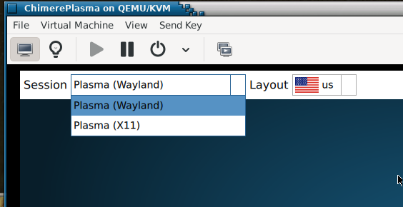

We can still have a look at Chimera. My Chimera is Plasma, not Gnome. It defaults to Wayland but offers a choice of Wayland or X11
Here is what is running if I choose Wayland

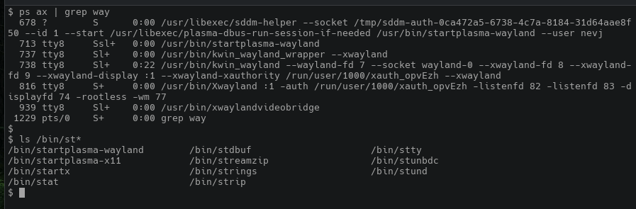

You can see the startup files are specific for plasma with wayland or X11.
/bin/startplasma-wayland is an executable… not a script
So that is not very helpful… sorry not helpful.

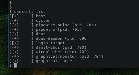

The services running are
No mention of Wayland? I expected something like an Xserver . Does Wayland not have a daemon?
It appears not
chimeradinit
Those are the dinit service files. There is no wayland?
If it were X11 I think there would be entries for the Xserver…No, I checked and I am wrong… why are there no daemons for either X11 or Wayland?

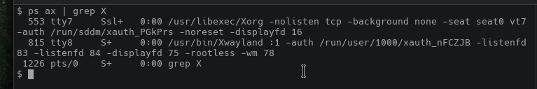

In X11, there is a program /usr/libexec/Xorg running in background, but it is not a daemon. I assume that is the Xserver.
In Wayland there are two background processes
So Xorg is still running under Wayland, but there is also a process Xwayland. Neither of these is a daemon… they are not listed as services.
I do not understand why the Xserver is not a daemon?
Have a look at /bin/start* in Pop!OS. You may find a start program for Gnome-Wayland.
