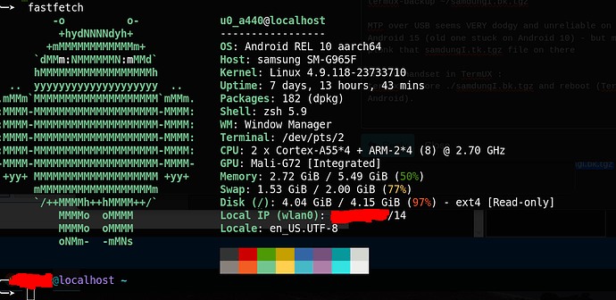

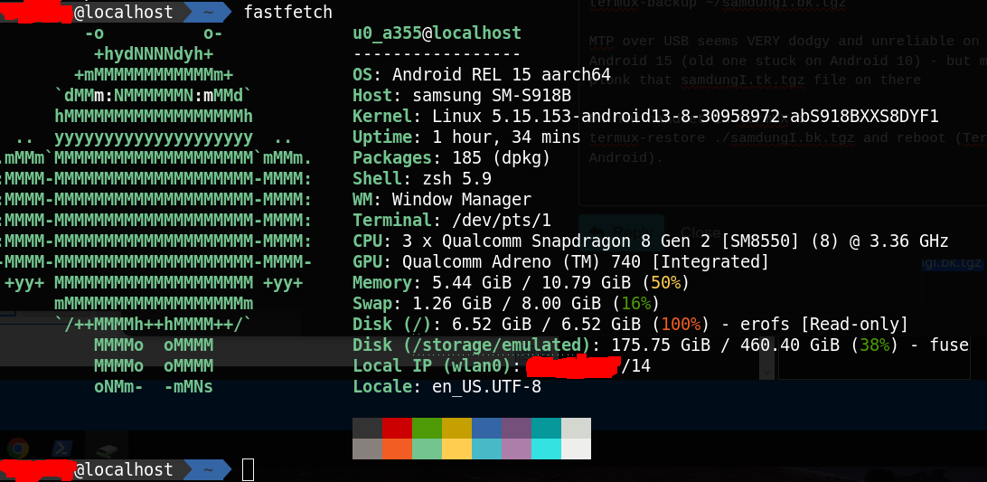

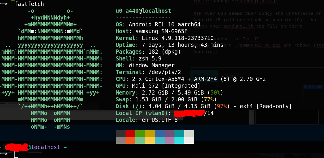

Arrived yesterday - took 2 attempts to transfer everything (nearly) from my old phone (S9+)… First time - I discovered, when new phone decided to update itself - it stopped the WiFi data migration - and the ONLY way to resume is to NOT resume it… i.e. Factory Reset the new device and kick it off again - this time around I used a USB-C to USB-C cable and it took about an hour (old phone was 64 GB onboard, and 512 GB SD-Card - new phone - no SD-Card and 512 GB onboard storage).
Happy so far… Slowly getting TermUX setup how I like it - with ZSH and “oh-my-zsh” and ability ssh to it (that was actually less painful than I thought it would be).
Some stuff in TermUX didn’t migrate over the USB cable.
So - I ran (in TermUX on old handset)
termux-backup ~/samdungI.bk.tgz
MTP over USB seems VERY dodgy and unreliable on the new Android 15 (old one stuck on Android 10) - but managed to plonk that samdungI.tk.tgz file on there).
On new handset in TermUX :
termux-restore ./samdungI.bk.tgz and reboot (TermUX - not Android).
Old device :
New device :
