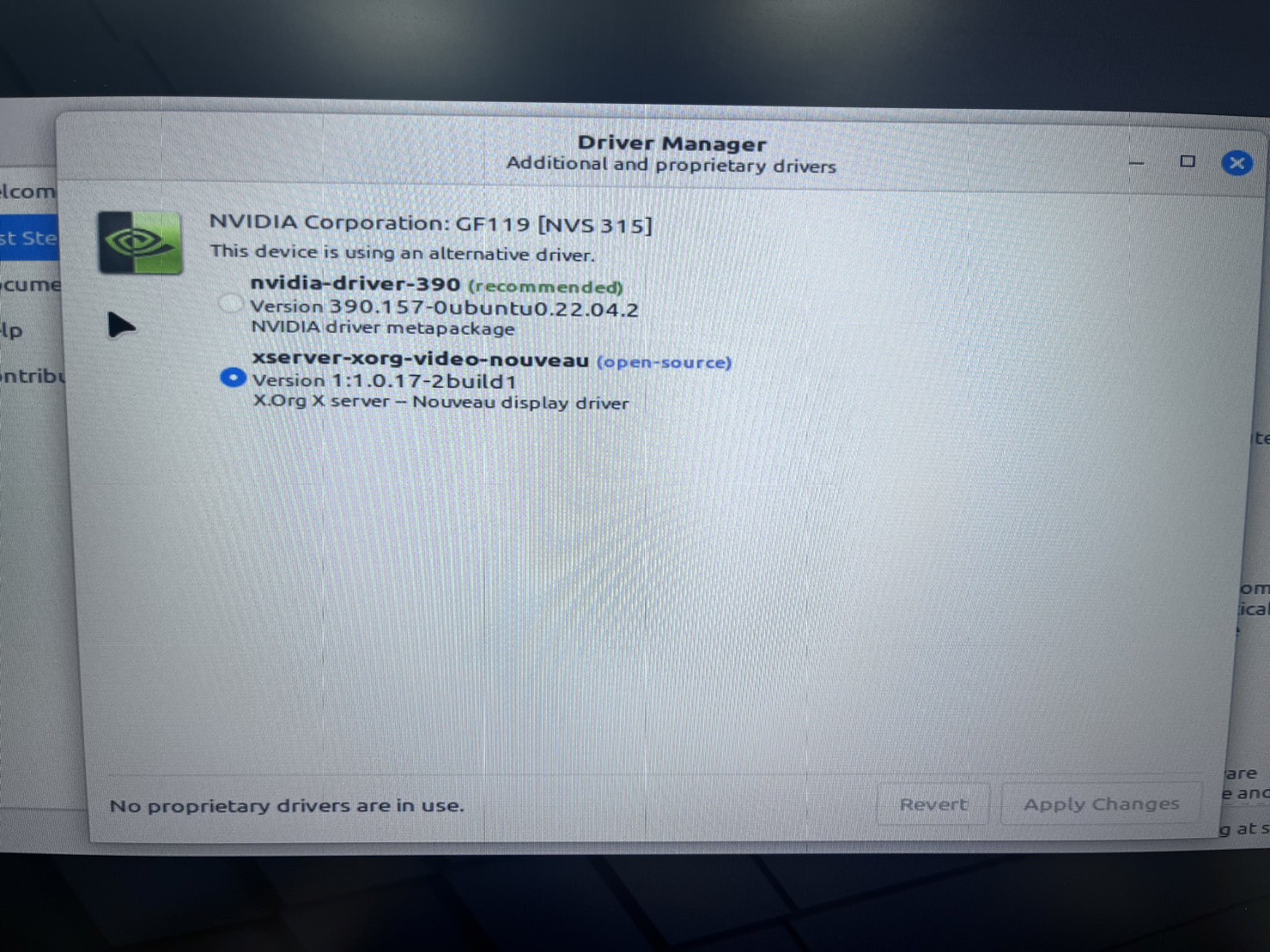

if I go to the drive manager,
I see this, should I change it to nvidia driver?

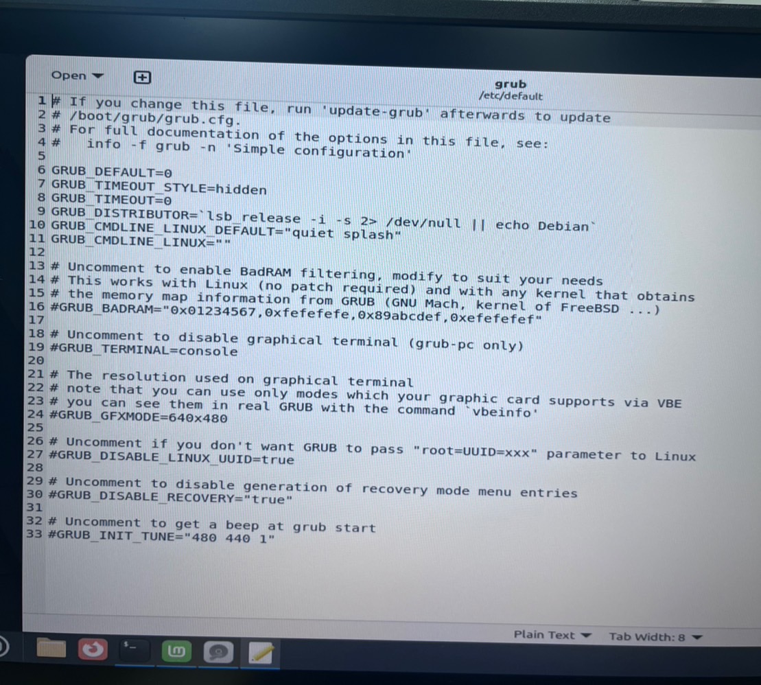

The grub screen will always be there.
Are you not able to log in?
Yes, I can log in.
every time I’ll login through the grub screen?
You login via the login screen. GRUB is there for presenting you various boot options, in case you need it. Normally you don’t need it.
I’d set GRUB timeout to a low delay, say 2 seconds. That is short enough to not bothering much, but still gives enough time to press a button, and interrupt boot sequence when there’s a problem to fix.
Do this with setting
GRUB_TIMEOUT=2
If you are absolutely sure you won’t need GRUB menu, set the timeout style to hidden. I see on your photo, you already did this.
But note, that if you edit /etc/default/grub (and save changes to it), you need to run
sudo update-grub
in order to make changes have an effect.

Now that’s a problem. This is likely because you have disabled the graphics card.
How can I solve it?
1- can I use nvidia driver from driver manager only? and would this solve the problem or no?
2- should I do this from grub list or with normal login ?
Don’t touch the grub unless required. It serves the purpose of giving you the option to boot into recovery, an older kernel and if you dual boot, into other operating systems.
Try installing the drivers and see if it works better.
after installing nvidia driver and restart.
I still can log in but the window is small and see this before log in
In your grub config there’s a line
GRUB_CMDLINE_LINUX_DEFAULT
Edit this to include loglevel=0
So it looks like GRUB_CMDLINE_LINUX_DEFAULT="quiet splash loglevel=0"
Run update-grub, and reboot.
Does it behave more nicely?
