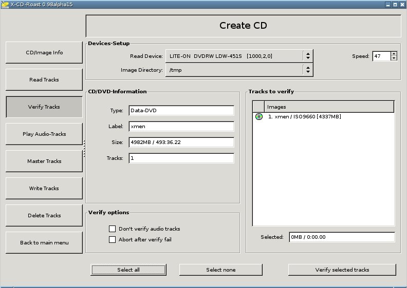

I don’t want to be the showstopper here, but there is 1 thing you should do at the very beginning when a live medium does not work:
Check the integrity of the output medium.
https://how-to.fandom.com/wiki/How_to_verify_a_burned_CD_or_DVD_image_on_Linux
