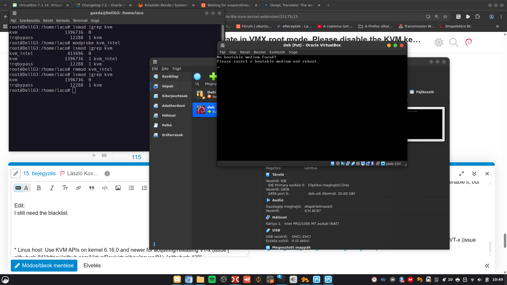

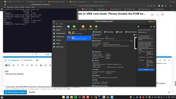

This was a mistake of me. My experience was gathered still on Debian 12, where I could fire up both Vbox and Virtman they just could not run VM’s simaultaneously - eg. either VBox or Virtman could launch a guest, once one was working the other could not launch any VM.
On Deb13 after blacklisting kvm_intel Virtmanager doesn’t work at all. I’d need to reenable it, but then Vbox would not run any VM, so I apologize.
I’ll check if undo my blacklisting of kvm, VBox still works?
The post from @JoelA suggests me it should. I’ll report it later.
Edit:
I still need the blacklist.
Note, kvm_intel is not loaded, so VM starts as it should:
Now Ioad kvm_intel, and see what happens:
After I unload that module, VM starts again as it should:
@JoelA pointed out, this would be fixed, obviously I’m on an older kernel than this is fixed for.
It tells, it’s fixed for 6.16 and newer, and while I have the latest VBox installed

I suggest to create a VM, install a Debian based Linux on to it, add systemback.sh and its dependencies. Create a resotore point, then do some irreversible damage to that system.
And try to restore…
The Issue 81 post I linked to (Sept 17) a maintainer states - The fix currently only addresses Intel hosts and targeted kernels 6.16.0+. A new fix for Intel hosts has been applied, will be available in the next maintenance release which fixes it for kernels 6.12.0+ as well. At the time they were still working on AMD. Current VirtualBox might work as far back as kernel 6.12.0
Thanks, I did not spot that sentence before.
So Debian users wait for the next maintenance release, or just have that module blacklisted.
I’m fine anyway with the current situation too, as it works now so.
Huge thanks to all for the valuable feedback, especially you @kovacslt by your detailed report :clinking_beer_mugs:
